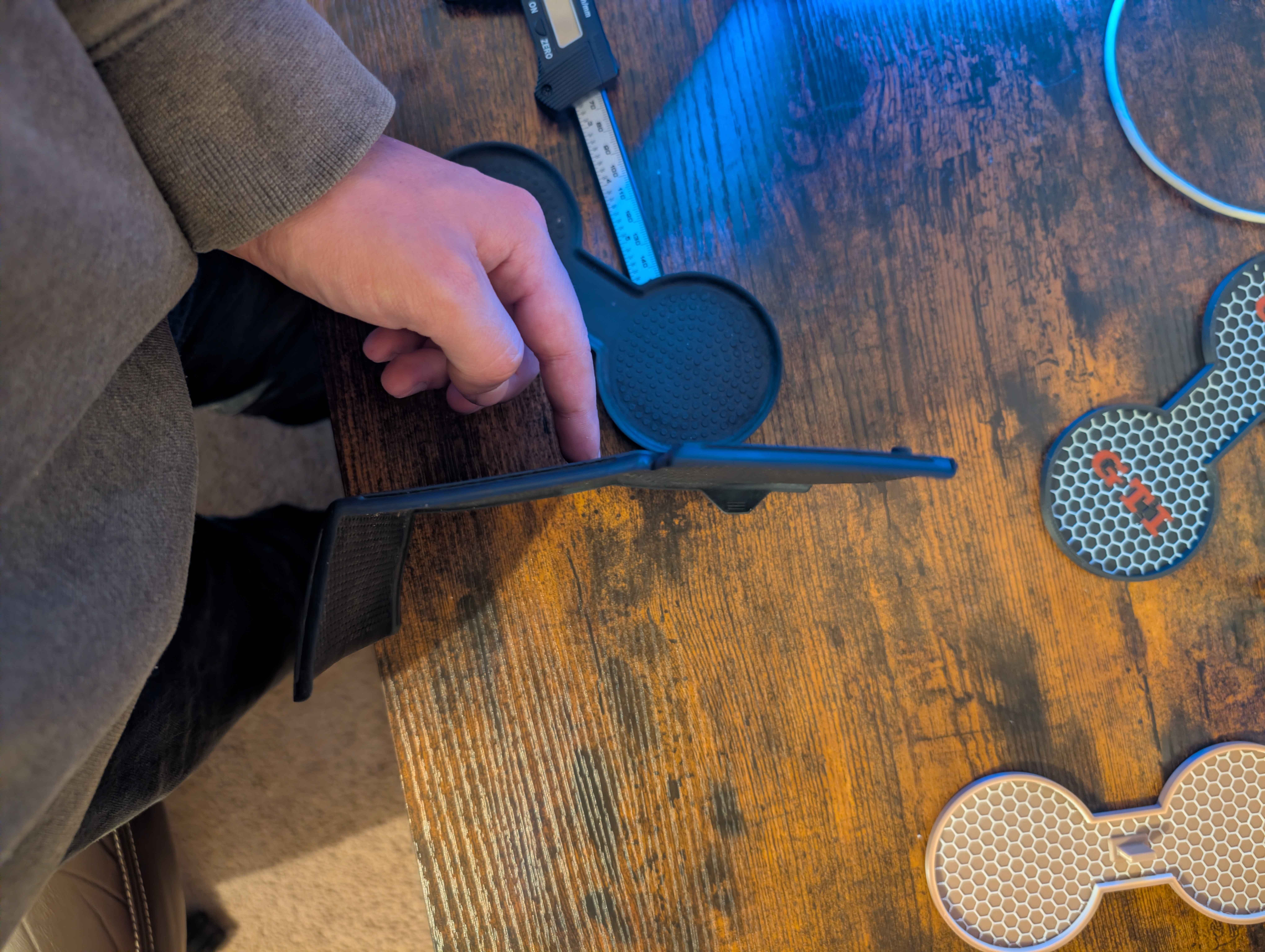

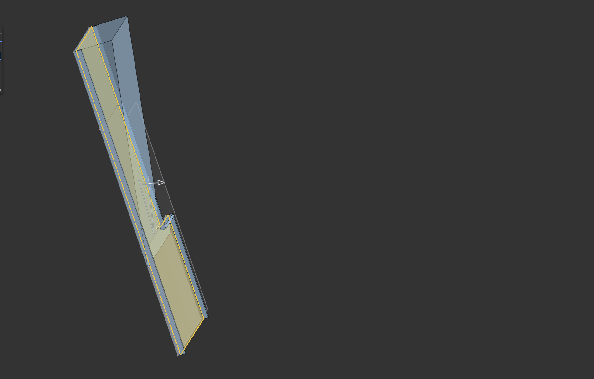

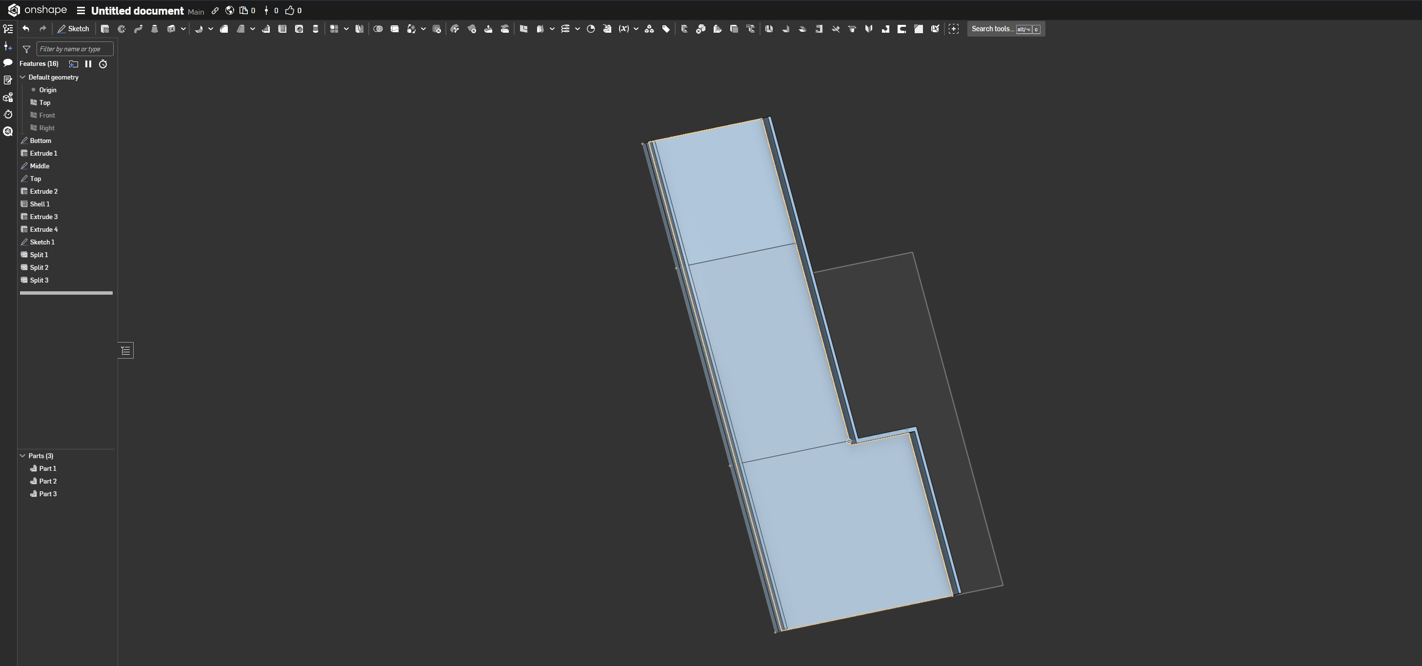

Thank you for taking your time and hopefully reading this... lol. I am new to CAD so please go easy on me. I am trying to model a tray for my car to replace. The tray has a "slope/angle" and fits snuggly into the compartment. I was able to split my face up into 3 faces (where I want to bend/angle/slope) but move face is not achieving what I want. I would appreciate anyone's help!

    Hello Thayne. Perhaps a simpler approach would be to create a sketch of straight lines that represent the flat areas of the tray, use the Extrude Thin tool to create 3 flat areas and see if what you then have enables you to continue from there to complete the part. Example document. - Scotty (GTI owner)

    I honestly cannot express how much I appreciate your help, with something probably so simple for you... lol. As you can see from the picture, I was able to successfully model myself the middle cup holder tray, which will be made from ASA in final.

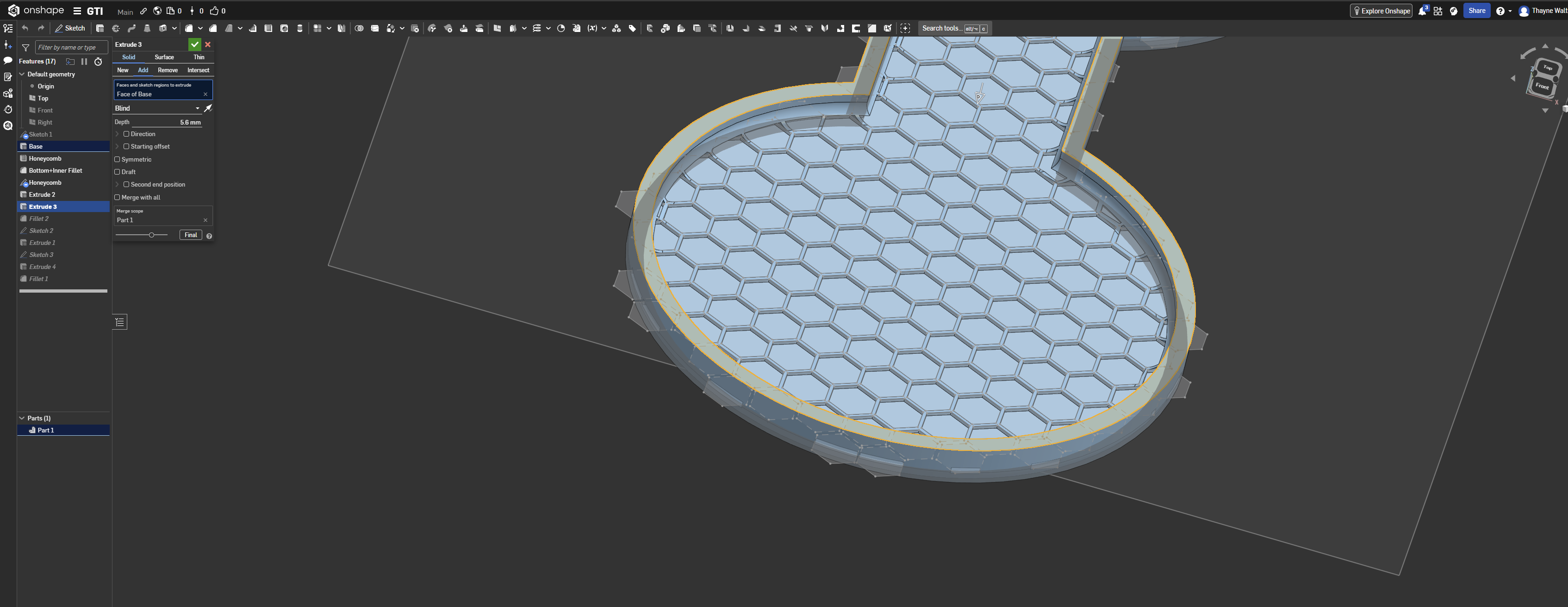

    Another quick question if you have a second, is there an easier way to model honeycomb? I am currently making one polygon, then doing a linear pattern and duplicating that across the plane. My only issue I have with that is I can't seem to have it mate perfectly up to the inside faces as I extrude the honeycomb down as a remove. This results in the part having holes and I have to extrude another wall down to "cover/hide" the holes. This is working on the final product, but I am sure there is a better way and would result in a cleaner part.

    I've updated the document of the link previously posted with an example. For your results (if you are able to do so based on what you already have) select the appropriate sketch entities and create a surface (a cookie cutter) and use it to split the pattern.
    Other than that method, there is a Custom Feature that might interest you.
