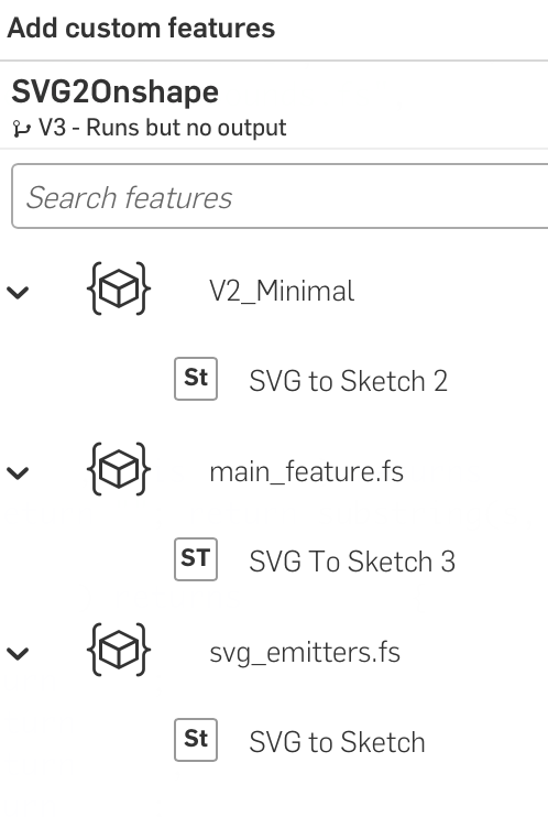

  • S1monS1mon Member Posts: 3,913 PRO
    This is really exciting. I'm also interested in your featurescript_guidelines.md. Perhaps a separate thread on your vibe coding process?
    I'm a bit confused why there are 3 custom features and their naming. Can this be clarified or cleaned up?

  • karl_mochelkarl_mochel Member Posts: 56 ✭✭
    edited December 2025
    @S1mon In the latest version there should just be an SVG to Sketch 46.2 FS tab. That is all you need.
