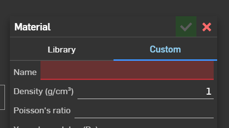

You're probably wondering what the use case here is. Cardboard boxes. Because of the fluting it's not a homogeneous material and trying to approximate a volume density is not the most accurate way of doing it.
You have a sheet metal part, and I'd like to apply a density value to the total area of the box. When I go to assign a material it would be cool if some materials could have a weight by area value.
Maybe just below density is Weight by Area (g/cm^2)
This might also be applicable to composite parts.
Is this a thing already in Onshape I don't know about?

    Do you need the density or to have the mass override calculated by the surface area?
    For cardboard, is it actually the surface area or the 2D area of the flat pattern? (You wouldn't be using the area of the sides/thickness of the part)
    Its not something Onshape has out of the box, but can be solved. I've written featurescripts to do mass override, sheet metal area, etc, definitely can be done.
    Shoot me an email and we can chat - caden.armstrong@smartbenchsoftware.com

    Hi Caden. Yes if I had a surface area value and a mass per area value say 100g per square meter, then I could easily calculate for the mass. Can I then use the mass override to assign that mass to the part? I'd like it to be driven somehow so that if I had many configurations of box sizes it would auto calc the mass. And go one step further by having different flute grades with their own mass per area values.
