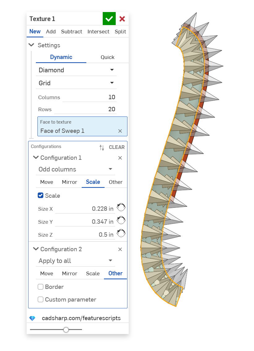

Hi Michael! Does this future script works with the latest Onshape version?
The moment i move the mouse or a little time passes the configuration menu closes without catching any parameters.
Is it only happening to me?
Thank you!0 -
Hi @marius_dalacu! Yes it does. Just tested. Texture Feature.
Due to Onshape's performance changes a few updates ago, editing logic has been slowed down greatly which is causing a delay when you change inputs in the UI. Try waiting until the added configuration fully loads before changing any inputs, this should help.

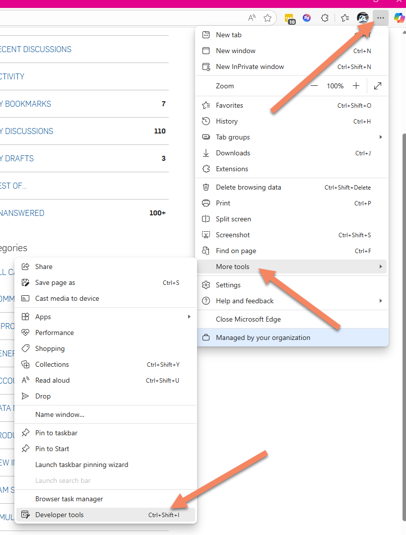

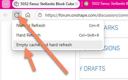

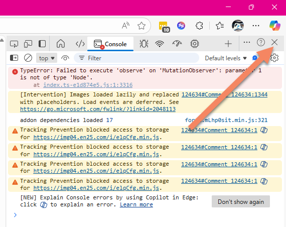

I had a similar experience yesterday with configurations.
Not with this featurescript but with something else.
I think this is a glitch with your browser's cache.
It only happened to me once. I thought it was my fault entering it too fast. But every time I tried to edit it would fail, or only pick up partial information.
To fix it reset my browser's cache and reloading. Haven't seen it since.
to reset you cache may be different on other browsers, here's how to do it on EDGE
Click the menu in the top right
go to more tools then developer tools
then right click your refresh button and choose empty cache and hard refresh
now you can close the developer console on the right
1 -
@john_mcclary the "configurations" he's talking about are technically a widget in the array parameter within the feature itself. Not an actual part studio configuration.

I tried updating the document to the latest Onshape version as well as the FS to the latest FS version. No improvement. Recently I had a ticket open for this exact issue but with the Logic Driven Feature. Onshape pushed some performance updates to fix this I think but I'm still seeing much lag with the texture feature inputs.

@MichaelPascoe Thank you for your prmpt resoonse, but waiting does not help, it closes by it self.
Also John, clearing the cache does not help.
I am using Chrome 143.0.7499.109 on Kubuntu 24.04.
Thank you.1 -

That's interesting @marius_dalacu. Can you share a video? Perhaps your accidentally using the dev version instead of the published version of the feature?

@MichaelPascoe Hi, sorry for late reply…
I am using this version ( i am new to OnShape..)
https://cad.onshape.com/documents/46897a2d60ade8dbb04077f3/v/d7a65c341cfc548161c9e87e/e/68452f8ffdcc0b0f041ffe43
This is a recording of the problem, after i press add configuration, i donțt press any mouse buttons antil the menu closes by it self…
I hope it explain the problem.
Thank you.0 -
@marius_dalacu that looks like it is working as expected to me, but it is reeaaallly slow. You are trying to edit things that are supposed to be hidden in the ui, but since it is loading so slowly, it is allowing you to start typing values anyways. Once it loads, you keep clearing it. Don't clear it after it loads.
What to do:
- Add a "Configuration"
- Wait for it to load and hide all of the UI. This is the part your getting stuck on. It is not supposed to be showing you those inputs.
- Once that "config" has loaded, select the different menu options you want and enable them with the check box.
I'm talking with Onshape about this issue now. Should be fixed soon.

@MichaelPascoe I understand now, yes it works! 😁
Thank you for your great add on and taking time to respond!
