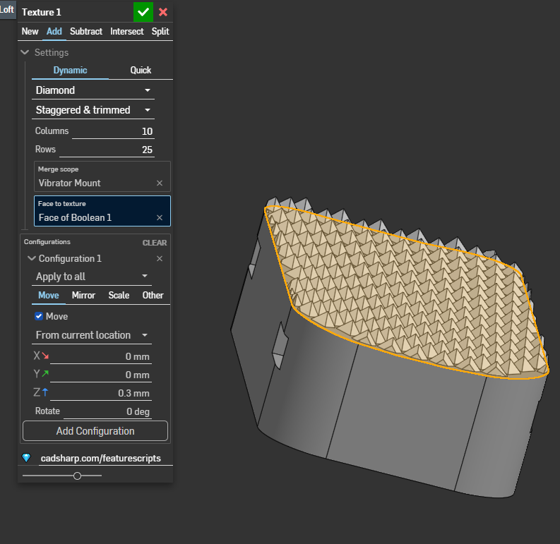

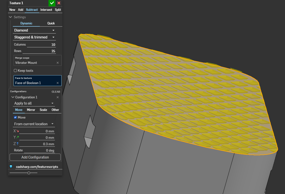

  • g_lewis
    g_lewis Member Posts: 4 PRO
    @MichaelPascoe Trying this out for the first time today. I'm struggling to get my texture to subtract from the part, but adding works just fine. Any tips?
  • g_lewis
  • MichaelPascoe
    @g_lewis try changing the pattern type to "Staggered" rather than "Staggered & Trimmed".
    Worst case, you have to create the texture as new parts then manually use the boolean feature to subtract.
    I'm in the middle of a re-write for the Texture feature that will have some major improvements. One of them being it will have the option to output the texture as a composite part, allowing you to easily do whatever you want with the grouped parts.
