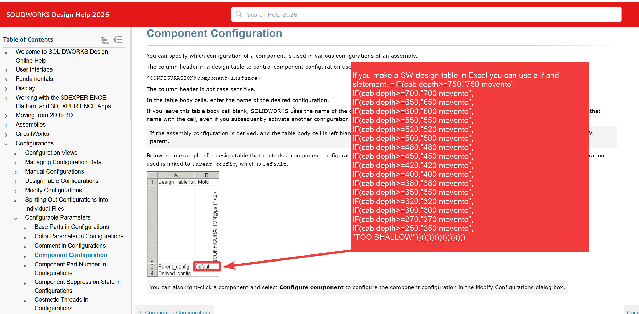

Hi @shawn_crocker good to know that you have matched SW features in Onshape. I don't have access to Solidworks anymore so I can't show you the example unfortunately. But basically you can add logic to a Solidworks Excel Design Table in the column $CONFIGURATION@component <instance>. See screenshot whereas eg "500 movento" is the name of the configured component to be inserted.
The goal is just to get a logic statement to a control insert of a configured component into an assembly. But I could totally be going around this in the wrong way and there's a better way to do it.
@troy_ostrander There different way to get what you want here. To keep it more similar to your example, I have set up a little doc that you can checkout here.
In Onshape, there is a conditional logic capability that functions just like the excel formula if(condition, do if true, do if false).
The way to do conditions is by using the same ternary logic that one would use in JavaScript. That is, condition ? do if true : do if false.
So, you can write in any variable or configuration input variable,
#depth < 20in ? "TOO SMALL" : (#depth < 100in ? 20in : (#depth < 150in ? 100in : (#depth < 200in ? 150in : 200in)))
In the example doc, I have created a variable studio which I have configured. I did not have to do this but I wanted to demo a nice clean way to create more complicated logic in one place which allows propagating that logic cleanly in any place. Because I programmed the variable within the variable studio to react as intended to changes to the #LENGTH input, we can now drop that variable in all over the place if we want and anything being driven by it also reacts as intended. We do not have to copy and paste the text of that logic all over the place. We can just change that one variable studio and everything referencing it immediately has access to that newly edited logic. You can also lock references to that variable by switching items to reference a version of the variable studio. This way you have greater control over deciding when a particular item should start using the updated logic to the variable or not at all.
