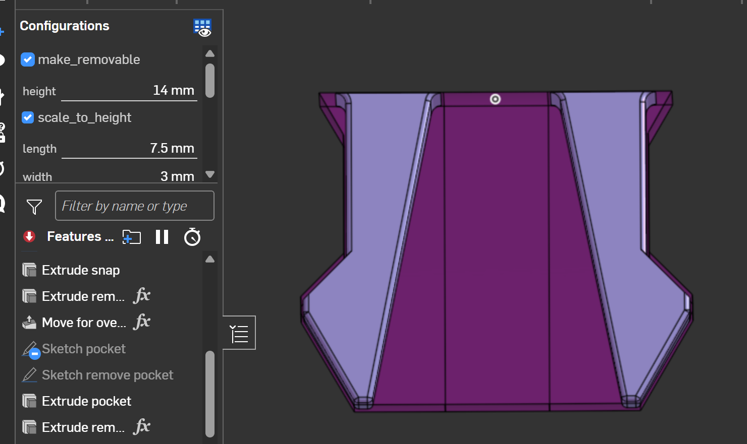

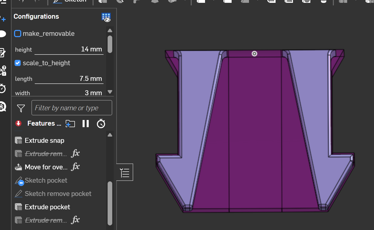

    Just can't get enough of how useful this add-in is. Thank you so much for sharing this creative and useful tool, I am using it all over! Adding logos, adding, snaps, dowels, locking dowels, screw holes, etc. It is awesome. I still can't wait to learn more about it. I feel like there is a whole 'nother layer to it with respect to the thread creator, but maybe that is more uses of the configuration parameters. Love it!
  • Derek_Van_Allen_BDDerek_Van_Allen_BD Member Posts: 693 PRO
    edited February 1
    This is a perfect example of where this feature shines. I know there are snap hook custom features people have made for Onshape but if their geometry isn't exactly right for your application you'd have to dig into their code and wrap your brain around it before modifying it - and that's assuming they programmed it any kind of reasonable. The other beauty is that any improvements to Onshape as a whole make this tool better by extension so if the developers ever add more functionality to configuration parameters like they did recently with conditional visibility, I don't need to update anything with Amalgamate in order for people to make use of the new functionality.
