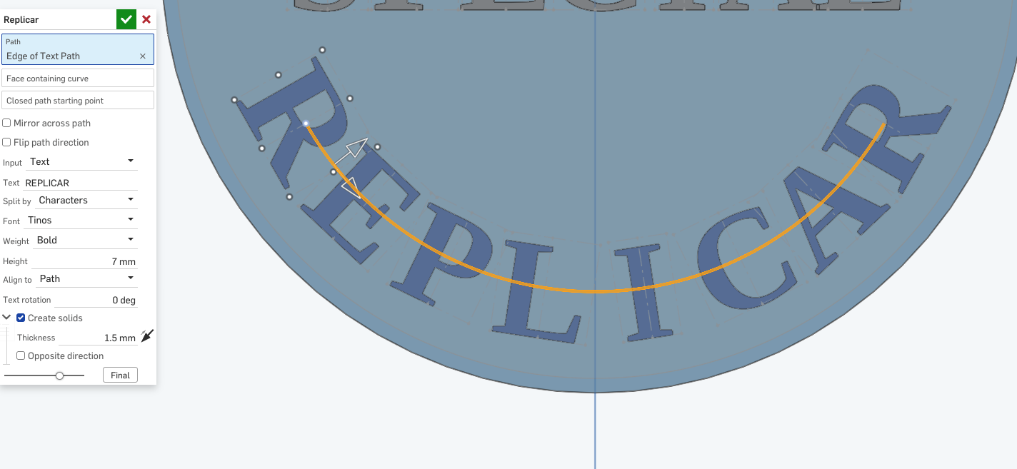

    @colin_haycock Yes, you can totally do that. What you are asking for is "kerning" which for various reasons is hard to make work the way you'd want (which is: automatically). The feature provides that control via "Adjust offsets":
    When you enable "Adjust offsets" a point manipulator appears on each letter (the white dots). You can click on the letter you want to move and drag it left or right to position it:
    And tweak letters in this fashion until you are happy with the result.
    Hope that helps!
