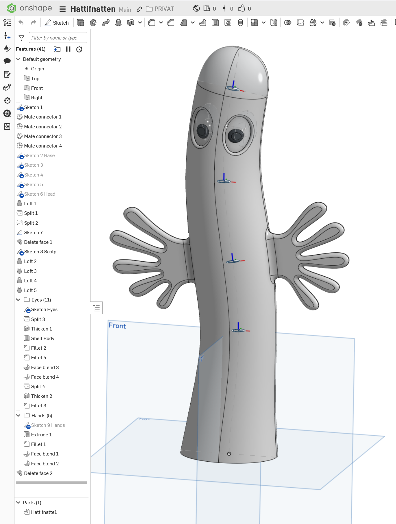

Today I have a highly important and sophisticated thing to print:
https://cad.onshape.com/documents/5ee24d7ba5cfd589e38e4f7f/w/c8f599f8c7daa51b8b094397/e/a9b01df0ac8265e70d9bf7ef?renderMode=0&uiState=694a88dbd706c06a49251f32I
I do of course need a bunch of them, in different sizes.

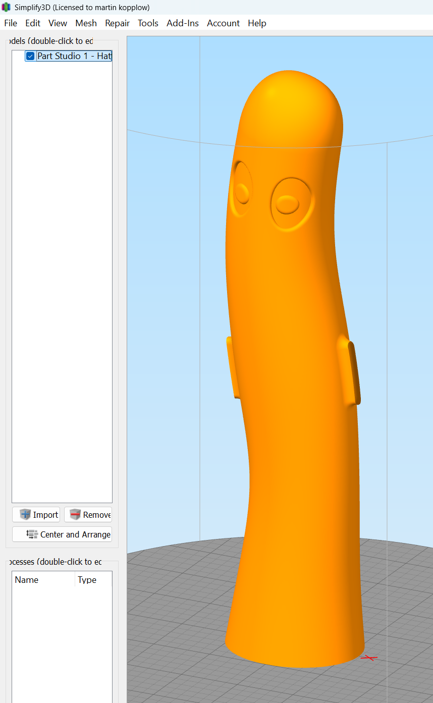

When exporting to STL, however, the 'fingers' don't get exported, and what I see in my slicer (and also an STL viewer) is this. Needless to say it doesn't meet all expectations the target audience might have. Does anyone have an explanation? It appears it could have to do with the face blend used between the body and the hands.
Edit: Nope. If I replace the the face blend with a fillet, it still don't work. It might be the (seemingly simplest) flat hand surface that has issues with the triangulation. What am I not seeing here?

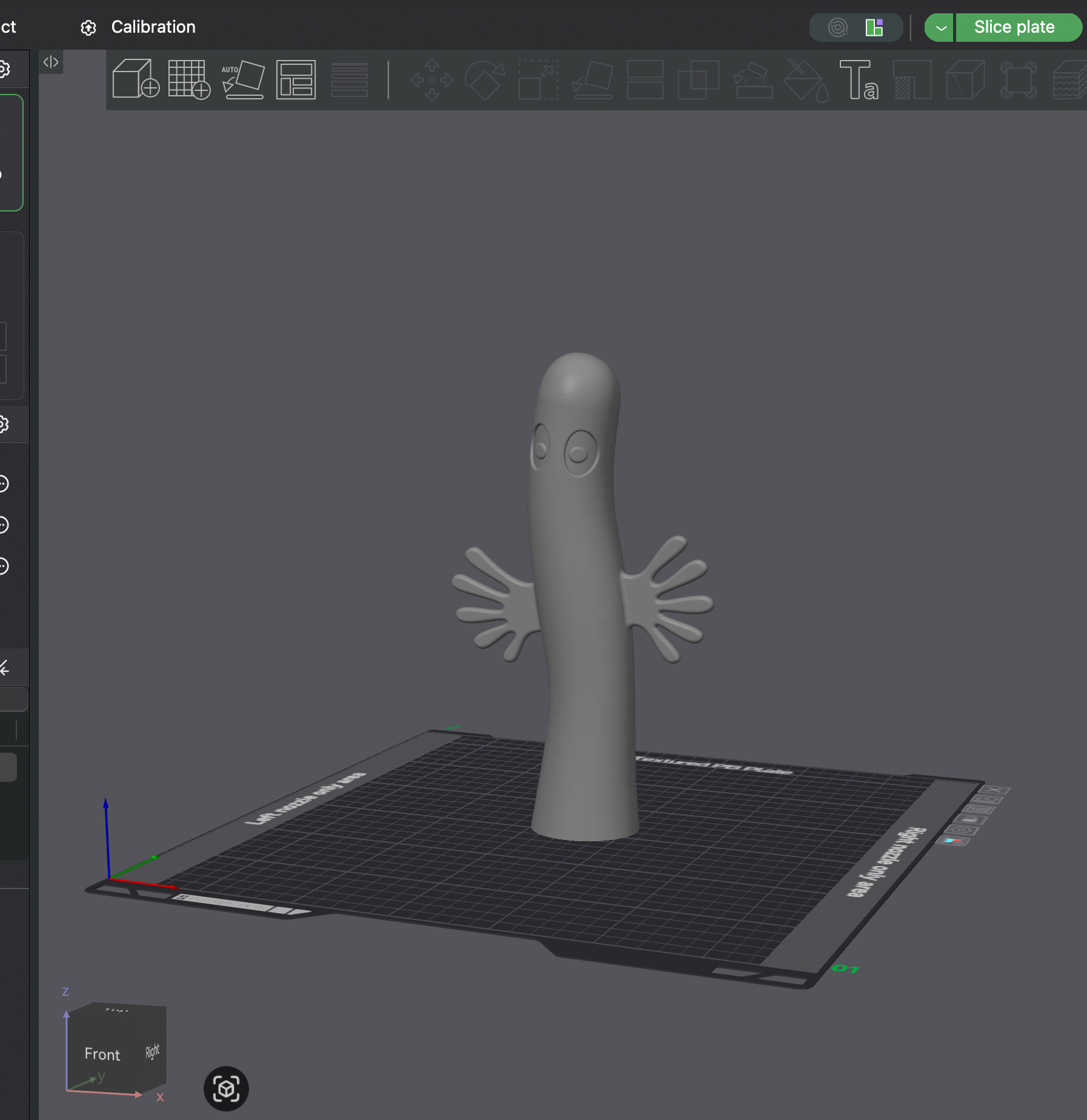

  • wayne_sauderwayne_sauder Member, csevp Posts: 641 PRO
    That is odd. It works fine for me. I'm on Mac and tried it with Bambu Studio.???

    It's because the fine setting in the export settings is probably not fine enough for your particular model. I've run into this multiple times and generally just use a custom setting. or export via step and then let my slicer remember how fine to import the step file.

    I used the Simplify3D Slicer, but it wasn't the slicer, it appears. When I re-imported the first STL files into OS, I got an error message (Imported with errors) and I saw the portions of the model were missing in the file itself.
    After investigating further, I found that possibly the minimum facet length setting was the issue. I used my standard custom settings for small things. Since I was mainly making bicycle accessory parts recently, I tweaked the settings so they would come out well without making the edge radius areas more complex than the formlabs printer could recreate anyway. I set an angular deviation and chordal tolerance pretty tight and relaxed minimum facet length a bit. Maybe just a bit too far.
