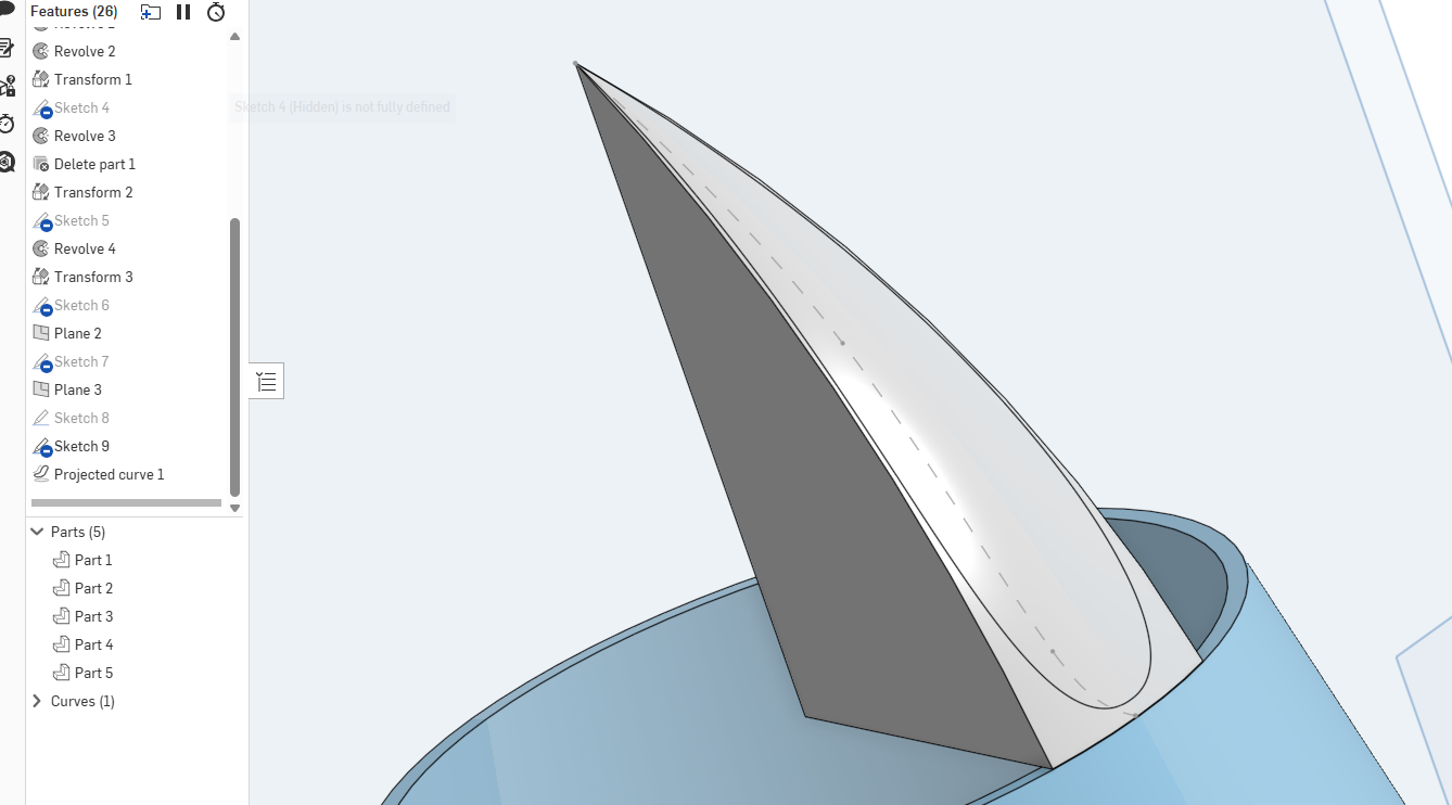

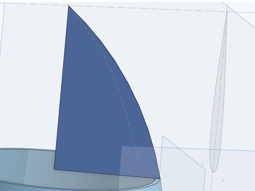

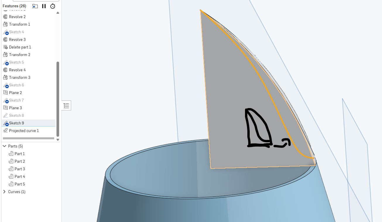

i projected a curve onto a cone and I want to extrude remove the projected part but profile of extrusion is a spline how do I go about that

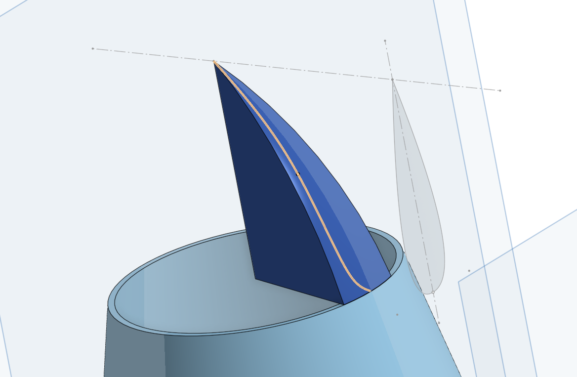

1
I did this with split part at a fill fill surface. The surface is done with a fill around the projected curve and a guide.
https://cad.onshape.com/documents/b1f0346f9bc35c891e696fcc/w/6b988c9ed4bb95022ac0f55e/e/ed00c3aa2c5dec23370056e0

yeah thanks I tried making a lemon juicer see it here:
