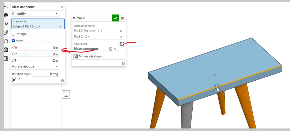

I keep pounding my head against the wall in situations where I'd love to have the three primary planes to work with in an assembly. In general they're incredibly useful for cutting sections, assembling, etc.
Lately I'm working on a large assembly with a lot of symmetry - think of a table with (a lot of) legs. I start by assembling the table top (drawn centered at the origin) and I'd love to mate just one leg and them mirror that leg around the front and side planes to end up with a clean assembly that shows the table top and one leg used four times. But there is no way I can find to mirror that first leg around the center of the table top.
I must be missing something because this seems so basic and simple - the Onshape folks are pretty smart and I don't think they'd leave me high and dry.
So what's the work around? I know there's a way to mirror around a mate connector placed at the origin but I can't seem to control that in any repeatable fashion.

    I see this seems to be going around still. Here is a sample using nothing but implicit mate connecters. The implicit mate connecters are easily adjusted to accomplish most things I need including orientation of the x-y plain and offsets.
    Select the mate connector symbol in the main dialog. In this case I selected the mid point of long table edge and adjusted z position by 2". The previous mirror is just the mid point of the short edge. The original leg was fastened to a corner with some adjustment. There are several implicit mate connecter on all parts. If you need the center of a hole or the like. To select open spaces like a hole, hover over the near by surface then hold the shift key and the hole center will will become selectable. This work flow covers more than 95% of what I need without including extra parts or surfaces or explicit mates. Note that I draw the main part relative to the origin so that it can simply be inserted and fixed. When necessary the methods described in previous posts will work as well for nonuniform shapes and the like.

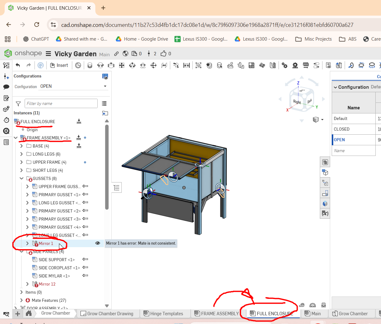

    OK, I hope I'm not beating a dead horse here - just trying to get better at onshape which is an awesome product and one that I'm a huge fan of - just trying to unlearn some old habits I guess.

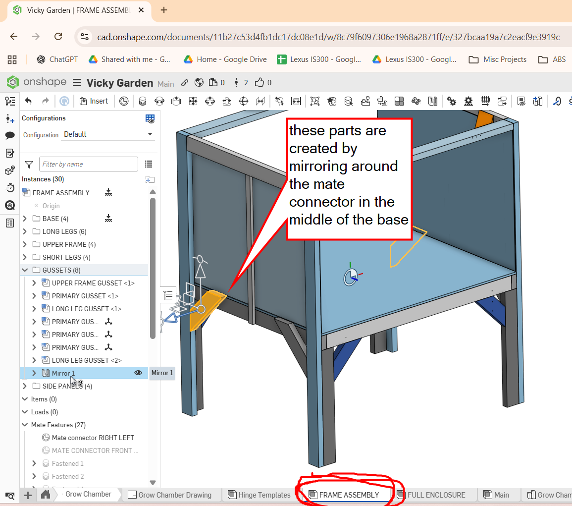

    Please forgive the simplistic model - I'm sketching out a quick grow chamber for my wife's native plant garden as a way of exploring how to better design with assembly context. I'm slowly getting the hang of it but having issues with this highly symmetrical design where parts are reused. I'd love to use assembly mirrors to keep my model tree clean and reduce the amount of mates - As you can see this part is symmetrically mirrored around the center of a base. I could use implicit mirrors on the side edges but I've chosen to create mate connectors at the center facing the front and side.
    Here's my latest struggle. When I create an assembly mirror in the Frame Assembly subassembly it works fin for mirroring parts….
    But when I assembly that subassembly into the next level up, suddenly the mirror is erroring out - I'm getting a "mate is not consistent" error.
    Is this a bug or am I doing something wrong here???
    It's not worth an incredible amount of effort to debug this - I can fix it by simply abandoning all my assembly mirrors and just manually reassembly all the parts even though they are symmetrically used. But if there is a fix or I can learn something that would be great as well.
    https://cad.onshape.com/documents/11b27c53d4fb1dc17dc08e1d/v/635fcd08ef909b555fe76fa9/e/ce31216f081ebfd60700a627?configuration=default&renderMode=0&uiState=694f0912fc34084a7c6aae88

    This error has something to with having created some in-context design btw… Something about my context design is messing things up…
  • martin_kopplowmartin_kopplow Member Posts: 1,110 PRO
    If the left and right side structures of your grow chamber are symmetrical, I'd recommend reflecting that in your assembly structure. Only design the right side insert that, and then apply assembly mirror to the whole side frame subassembly, instead of individual parts. That'll get you around lots of confusing dependencies. In-context design would then happen only inside the side frame subassy, and not interfere with the top level assembly mirror.
