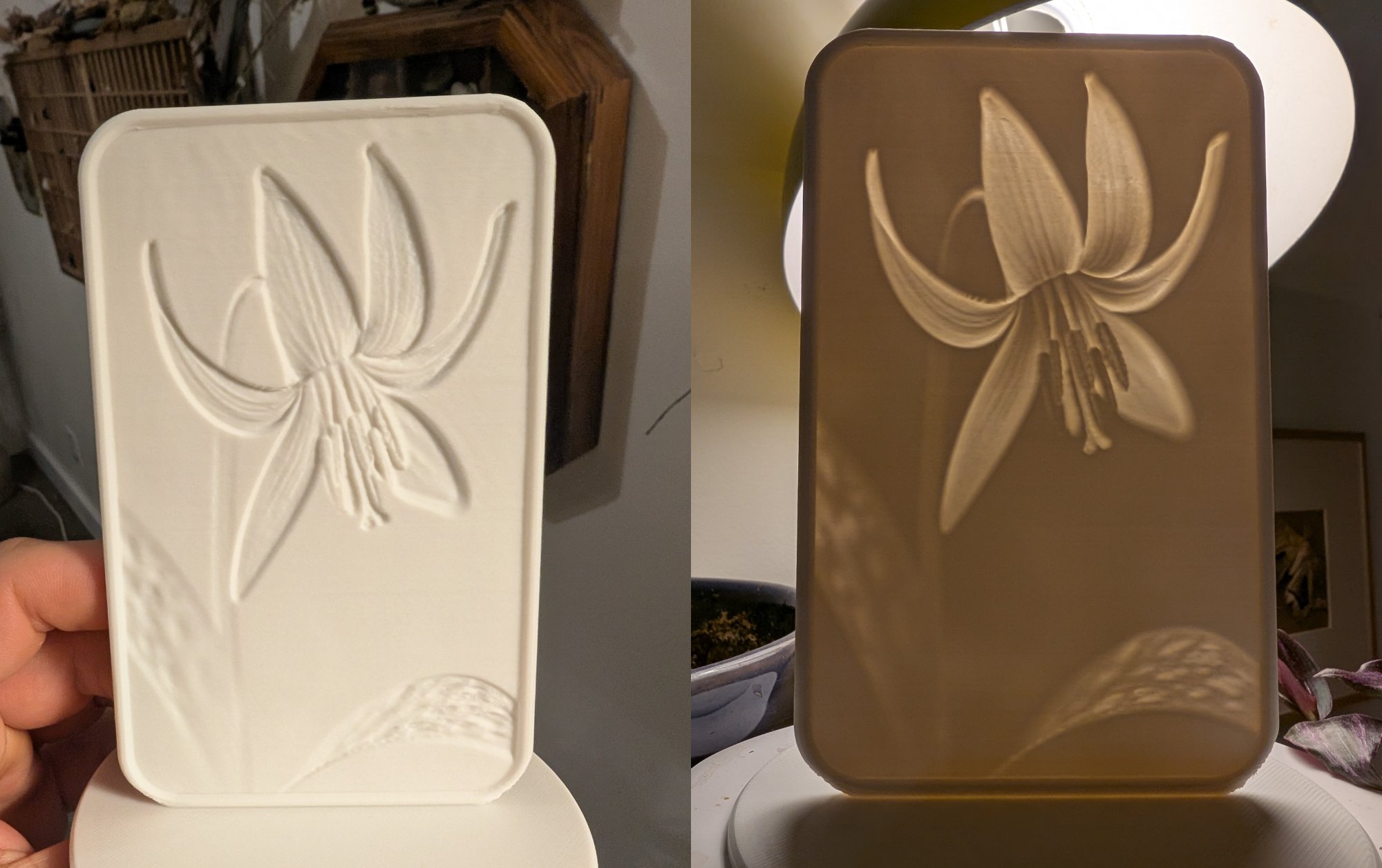

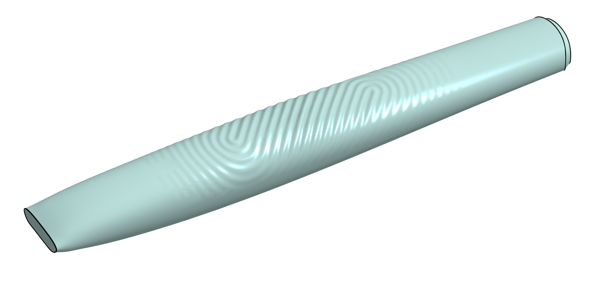

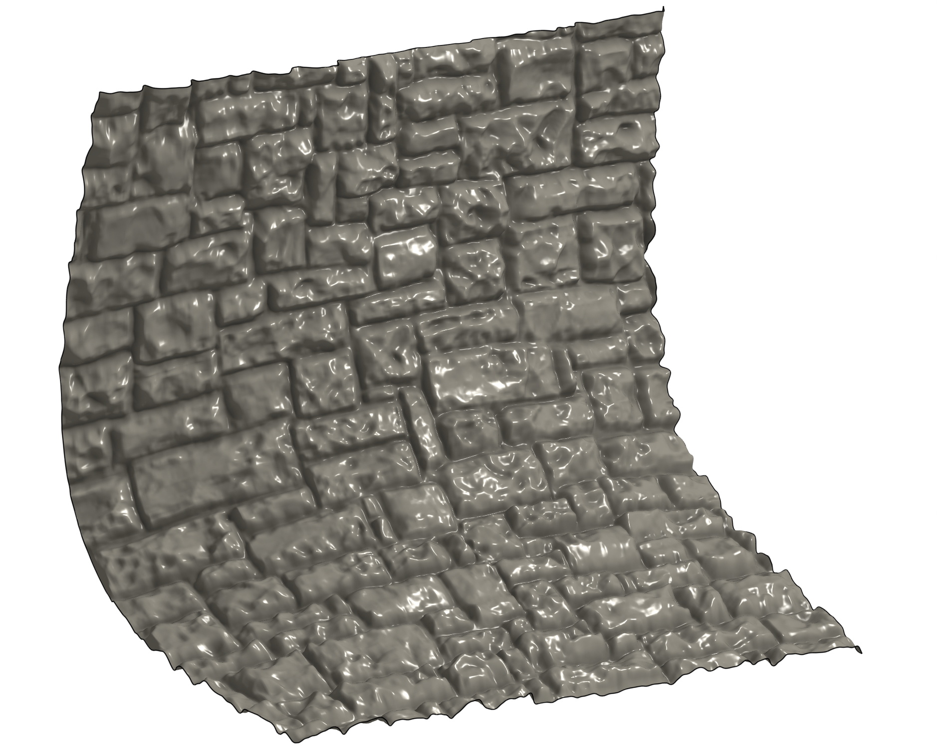

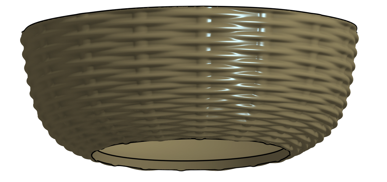

I'm really excited to share this one. I've finally figured out how to get pixel values into a format that FeatureScript can process, which opens up a number of interesting possibilities. First up in that list is using images to modify surfaces. There's a whole video on the topic, so I won't detail it here, but here are some teasers of what's possible.

    @EvanReese Video and Document are private. This looks really cool though! Can't wait to see it, this sounds insane!
    From what I can tell in the pictures, looks like your generating one surface that has points controlling it from the heightmap of an image. Then applying the original image to the surface? Brilliant work. This is a game changer.

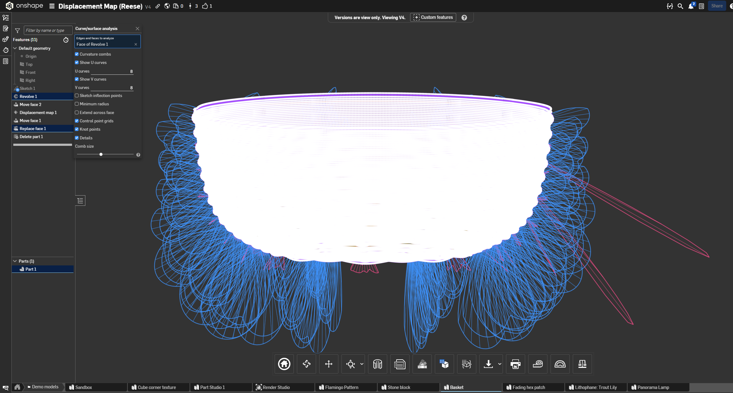

  • Derek_Van_Allen_BDDerek_Van_Allen_BD Member Posts: 507 PRO
    Heads up for anyone viewing in dark mode: the surface analysis tool is going to blind you.
    Smooth combs tho
