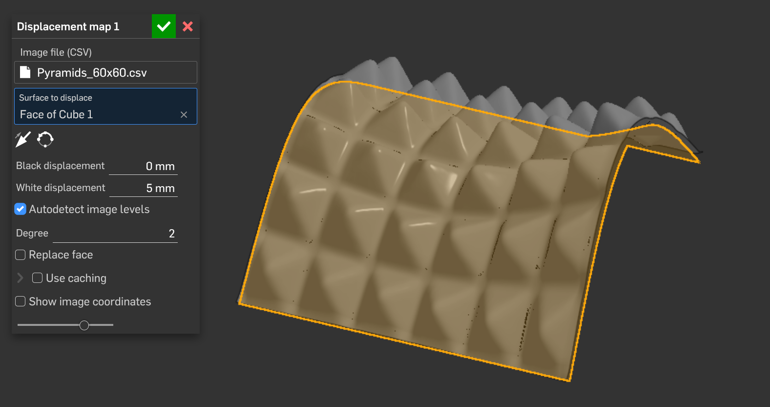

I'm really excited to share this one. I've finally figured out how to get pixel values into a format that FeatureScript can process, which opens up a number of interesting possibilities. First up in that list is using images to modify surfaces. There's a whole video on the topic, so I won't detail it here, but here are some teasers of what's possible.
Link to feature

    From what I can tell in the pictures, looks like your generating one surface that has points controlling it from the heightmap of an image. Then applying the original image to the surface? Brilliant work. This is a game changer.

    @S1mon There already are flip/rotate buttons, which should be able to get you what you need, though it could be a few clicks. Lemme know if it's not enough to get you there.

    Yep. With the flip and rotate you can get to the result I was trying to achieve fairly easily. The flip/rotate choices are not visible other than in the preview of the displacement itself, but maybe that's ok. This test is using the P image_50x50.csv file from your document.
    Another request/idea: it would be great if there was a variation on Attractor Pattern ("Image Pattern"?) which used the same image→CSV flow to control the size/positioning of the patterned entities.
    To the official Onshape crew: please make it so that we can just import images into features like this directly without a conversion to .CSV first.
    I'd love to be able to preview the displacement with the basic image - the same way one does with the decal feature.

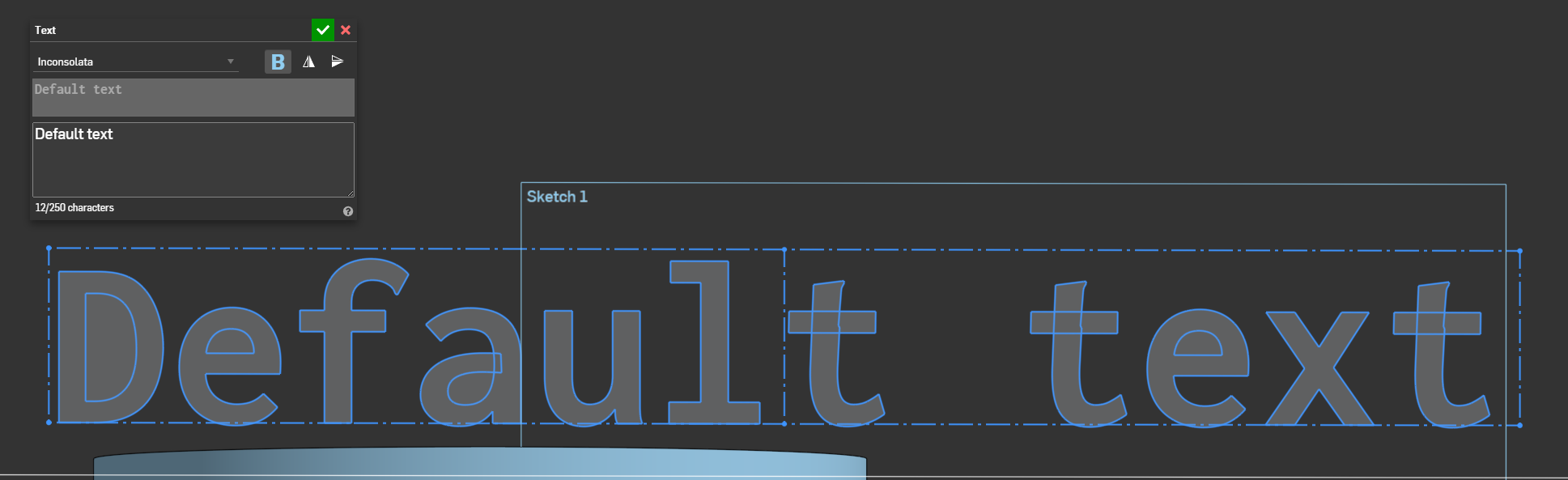

  • Caden_ArmstrongCaden_Armstrong Member Posts: 399 PRO
    This is super impressive. What amazes me is that the regen time is pretty good.

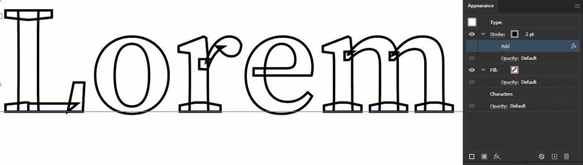

    This could be a helpful solution for people who need unsupported fonts.
  • EvanReeseEvanReese Member, Mentor Posts: 2,837 PRO
    Thanks, Caden! I was digging into this for fonts last week as I was making the Image-to-CSV converter it and it seems doable. It should be possible to make a converter that accepts OTF and TTF files, and returns a JSON of the relevant info, including name, style, and most importantly, control points for cubic beziers to draw the characters.
  • S1monS1mon Member Posts: 4,010 PRO
    The real problem is that many (most?) fonts have areas where there will be manifold issues with the Parasolid kernel. In some fonts, the 'P' below might have a join at a single point, and the thin strokes could present challenges. The "Lorem" shows that many fonts include - hidden to the average user - areas that overlap.
    https://community.adobe.com/t5/image/serverpage/image-id/501918i7AEBCA923886DDB4?v=v2
  • Derek_Van_Allen_BDDerek_Van_Allen_BD Member Posts: 761 PRO
    I think I have seen cases in the standard Onshape font set that have self intersecting geometry like that when set to the right combo of bold or italics. Either way Solidworks has custom font support and gets away with it, and it's running Parasolid too.
    hmm could complicate things. I'd love a native implementation really.
    I was thinking you make the text in something like Photoshop, export it as an image, and then use this feature. Not perfect, but it's a solution that exists without any additional development.
    The smoothing would take care of any manifold issues.

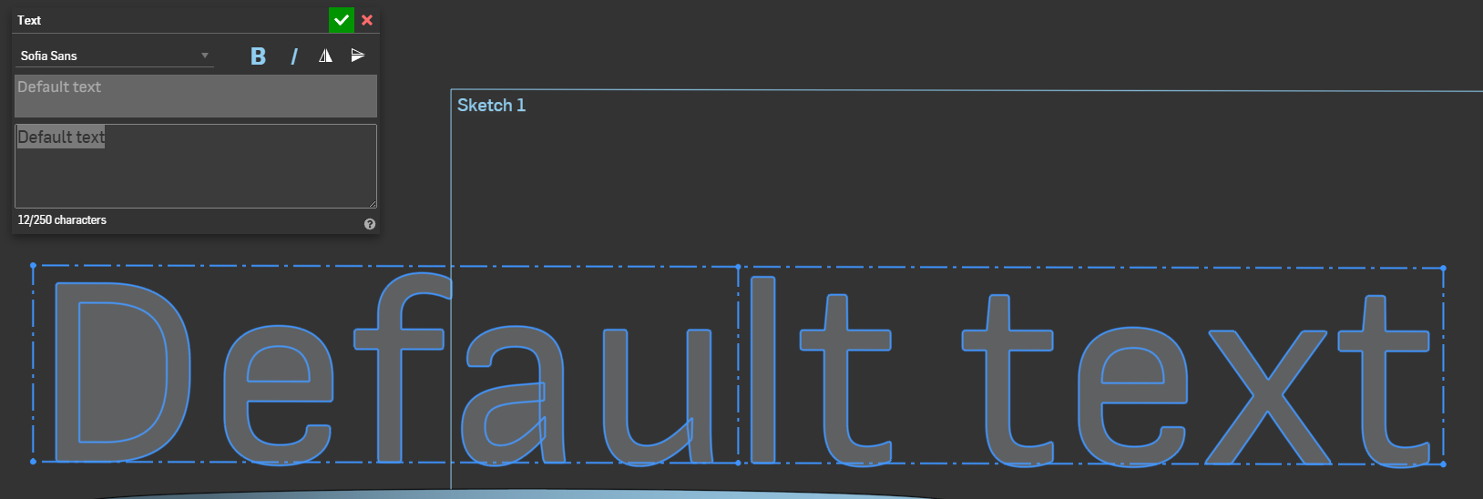

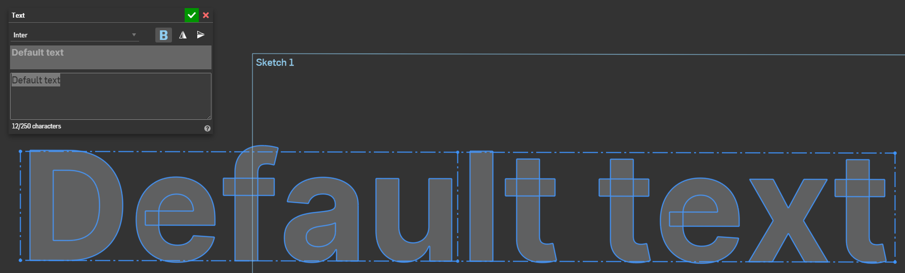

    INCONSOLATA
    INTER
    SOFIA SANS
    All guilty fonts in the default lineup. Suffice to say that if the goal is a font to CSV interpreter, it's not gonna be any worse than some of the options available in the software already. To test I just drew a random set of rectangles with the same kind of defects we're talking about these fonts having and the self clipping geometry resolves just fine without manual region selection.

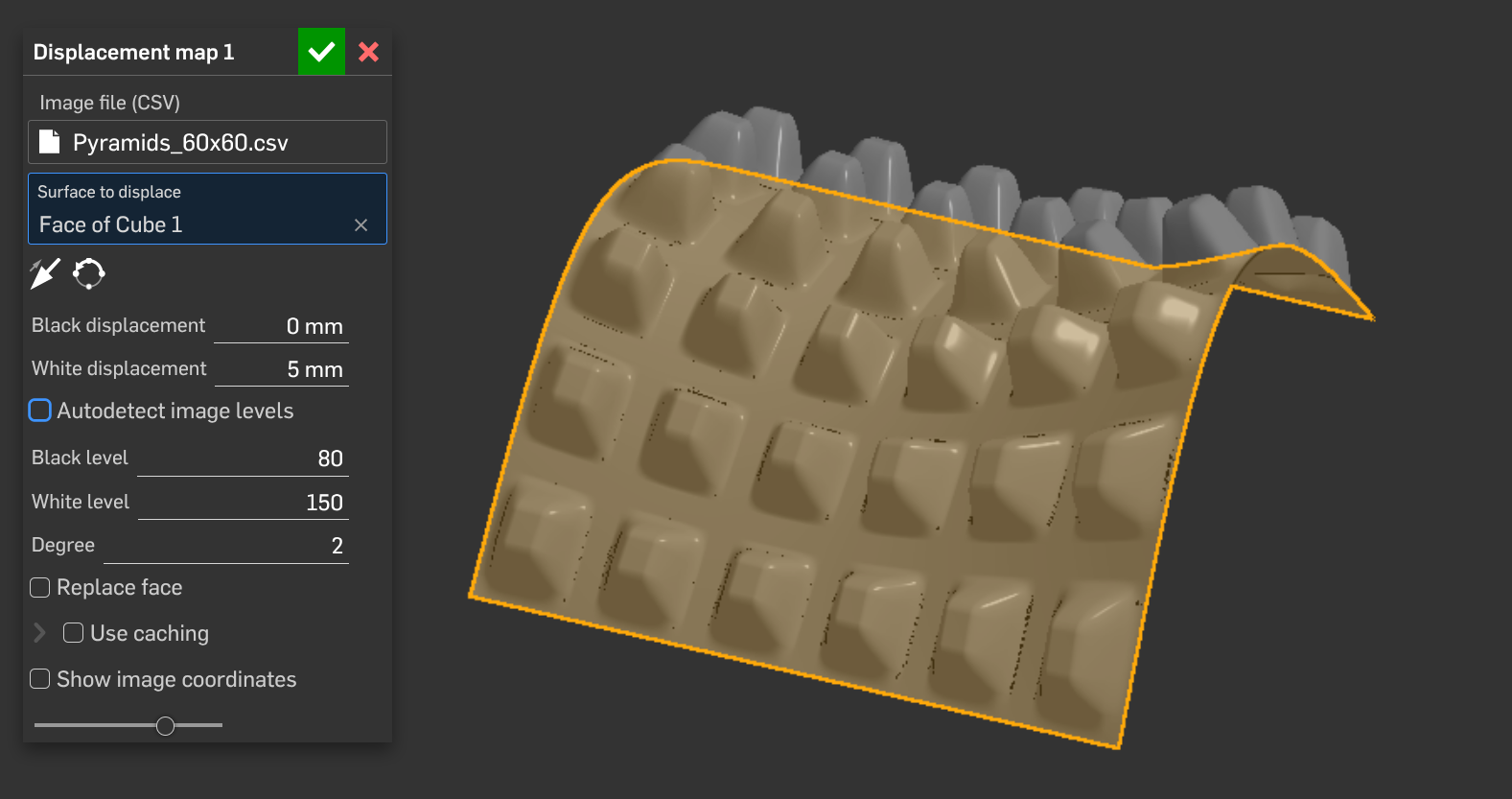

    thanks evan! so, i haven't actually used this yet but i didn't like how in your video you had to use the image editor to adjust the white/black levels in the image to give it the full range of the displacement parameters. it took forever because i think there's something going on with too-big-of-stuff getting stuck in the cache, but… any interest in including something like this in your feature? i had some other thoughts as well about adding tiling rather than requiring the tiling be done in the image. i know there's a limit to the flexibility that can be reasonably provided, but there might be a couple more things that could be cleanly added.
    diff: Displacement Map (Reese) - adding image level controls
    source: https://gist.github.com/altendky/28dfbb871cb8a6d5082832e6ec16aab1

    Thanks for weighing in and getting that mocked up. It looks like you're pretty much using a clamp() function (though the code looks more like AI did it the long way). I personally prefer keeping that stuff in the image editor for a few reasons:
    1. The more math the feature has to do, the slower it will be. Moving the levels to the image processing makes the feature faster.
    2. Doing the levels is somewhat of an art. Sure I could calculate the range of the values and normalize them all so that they go from 0 to 1 all the way, but in my example, I pulled the levels a little bit past that and got a bit of desirable clipping at the ends of those long bellcurve tails, which I did by intuition, not math. To create that kind of intuitive interaction in the feature is a non-trivial amount of work, but that's what I'd find most useful. I prefer having a dedicated suite of powerful interactive image editing tools to use.
    3. I really only had to adjust levels because I was working from the wrong input image (bump map, not displacement map), but I included it in the video just to have one more example of a way to edit that people might find useful. In reality it's not a required step most of the time.
    As for tiling, that's another one where it's a lot better to do the math outside of FeatureScript. It's not that it's impossible, but for how I'll use this feature I don't feel the juice is worth the squeeze. If I did implement it I'd suggest that people produce a very small CSV of just one tile (with very few points, like 5x5 or 10x10) and it could repeat it. One concern with adding tiling is that people will already be overloading the point count with big images (like 250x250 +) then tile them and multiply that many times over. I suppose I could just let people make their mistakes or cap the number of points allowed, but I don't see the issue just making my edits to the image for this too.
