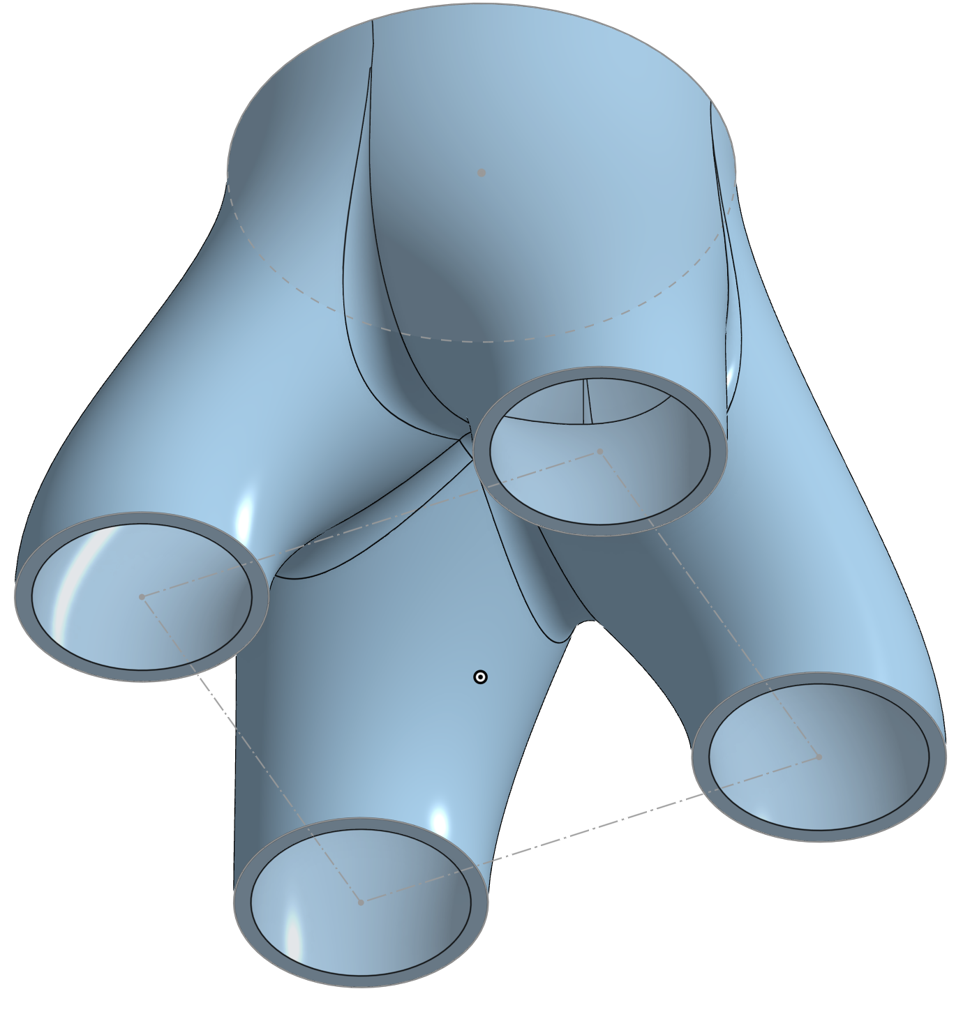

I'm having a problem with a Shell command failure. I have four small circles that loft into one larger circle. See document https://cad.onshape.com/documents/72fe1b29cc9f99b5f2970754/w/5bf8ad1214aa3202e45ea861/e/2c70e0adbf6fad39d06bd7cf If you un-suppress loft number 4 the shell will fail. If you suppress loft 3 or 2 then the shell will work again. Only if all four lofts are active will the shell command fail. Any ideas?
Smoothing the joints helps.
https://cad.onshape.com/documents/f2f3530dba5a703b6da0e00c/w/d4036b6de6b2640b468b9a90/e/eff77478d486b2d220066b5a
That was a simple fix. Thanks
