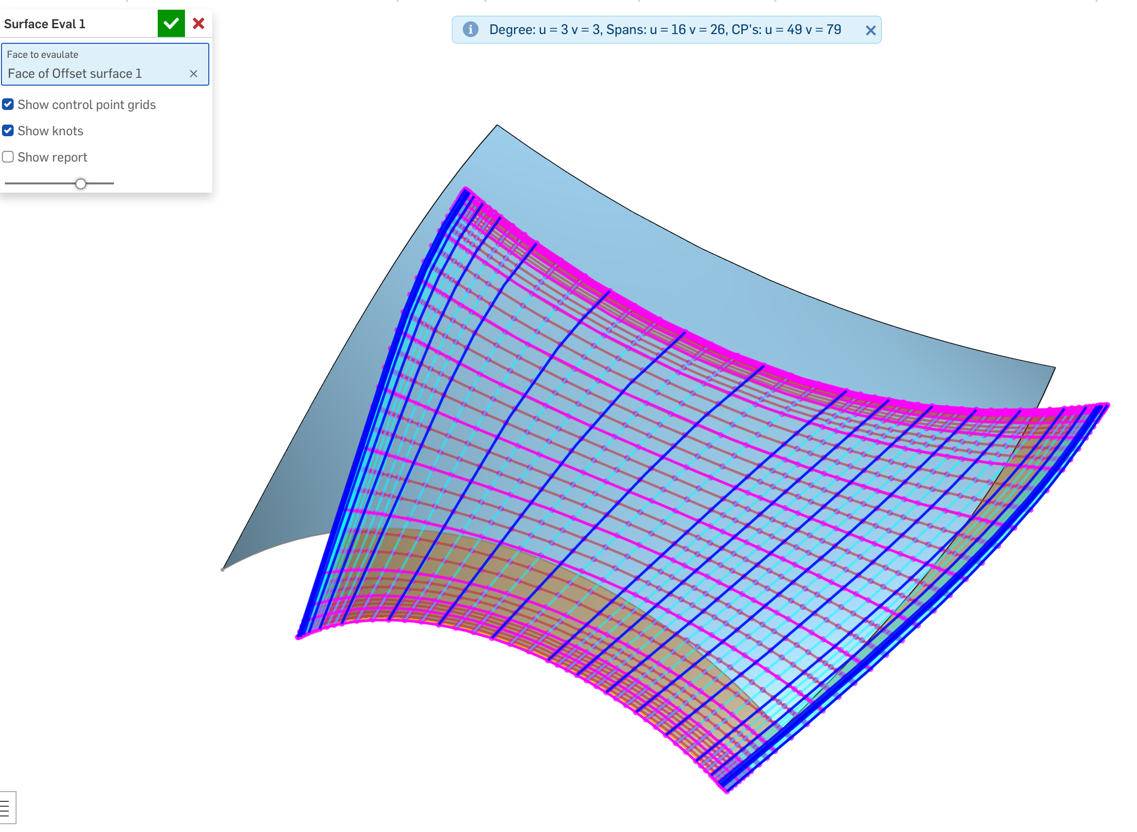

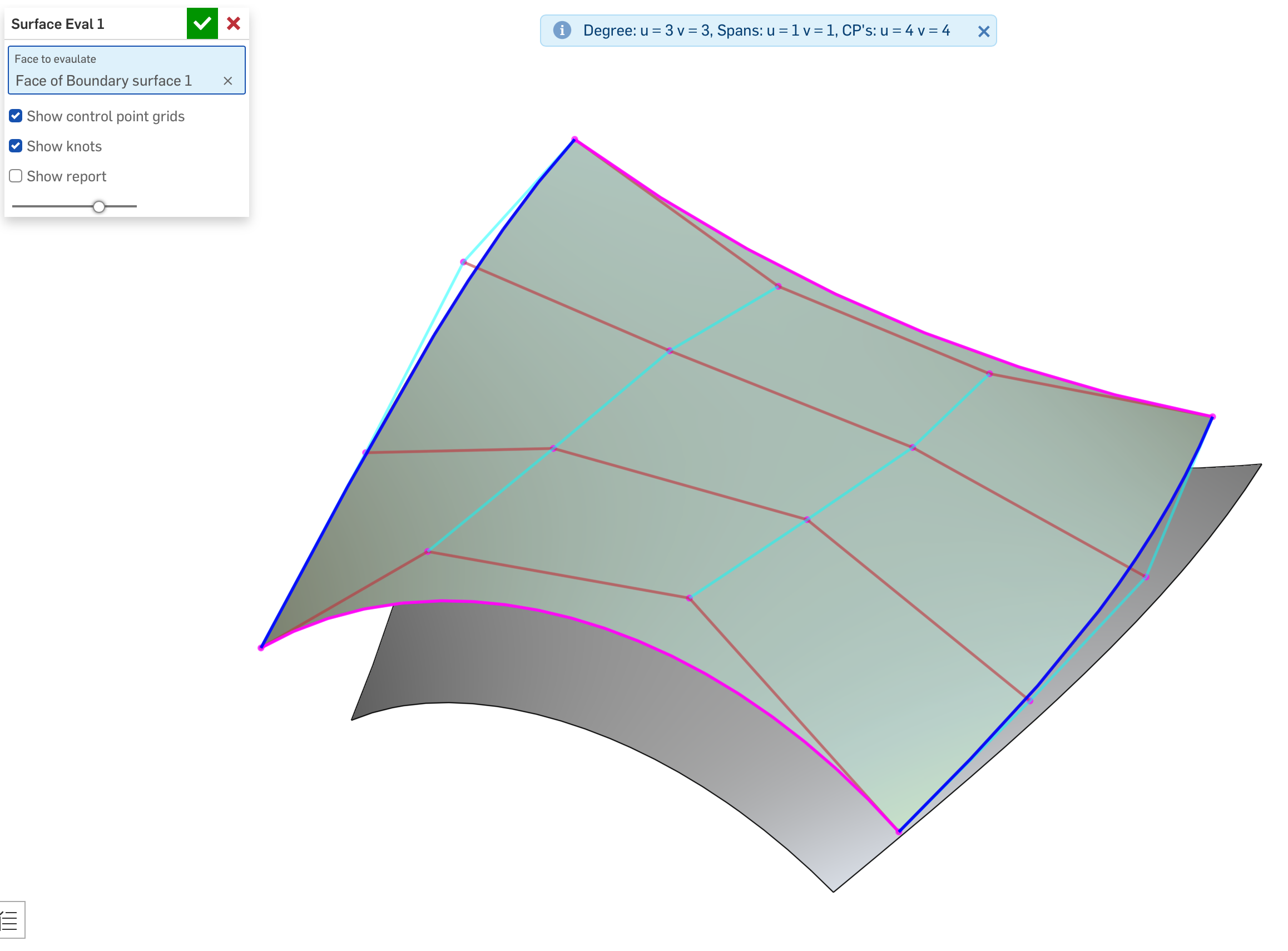

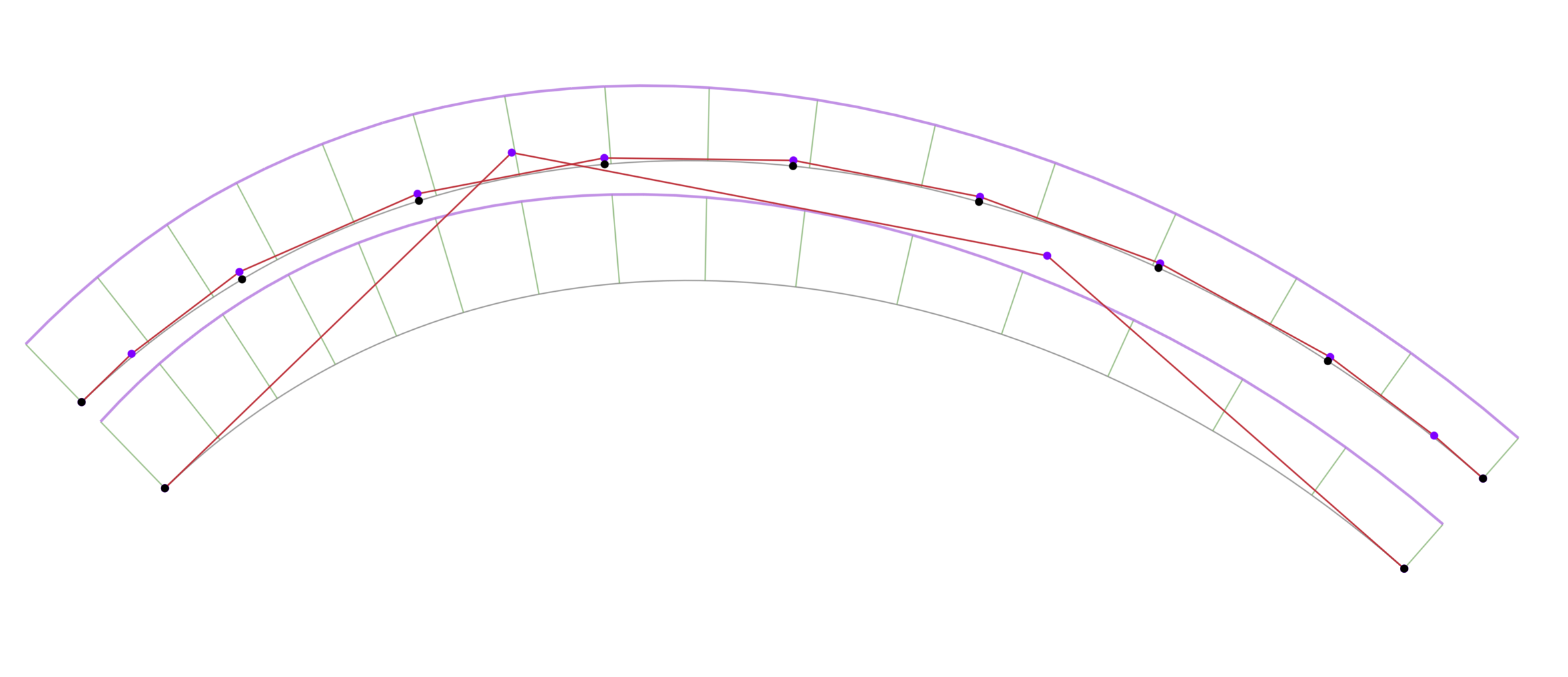

A simple test in Onshape will show that the offsetting tools that are built in do not result in the offsets having the same control points, knots and parameterization. Here's a simple 2D version in sketcher. The single span degree 3 Bézier is the base curve, and the multi-span degree 3 curve is the offset (created in the sketcher).

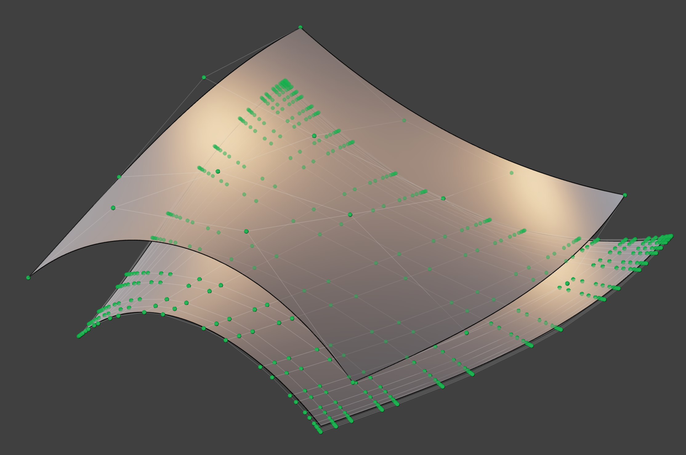

In 3D, I made a simple degree 3x3 surface in Onshape and offset it. The curvature analysis tools in Onshape won't display the control points or knots, but I exported the surfaces into Plasticity and was able to display the CVs, and the offset is indeed many many spans of degree 3.

Derek Van Allen | Engineering Consultant | Meddler@GregBrown made a script to show both control points and knots. Fingers crossed it'll make it into native Onshape someday.
Link to feature: Surface Eval
Ramon Yip | glassboard.com
@ry_gb fair warning that his script (and also my own version I developed before learning about his better implementation) run on evApproximateBSplineSurface() which is technically always locked to an approximation bounds so you're not getting the true pure surface definition in some cases.
I did try running some face curves features on some offset cases on a 10x10 grid to see if the UV parameterization of an offset surface matches the parent at all and it looks like that's a pretty well behaved metric to go by. All of the point pairs on my grids have distances which are very close to the original offset dimension so if you extract the full untrimmed surfaces and sample a number of points by raw UV positions and all of your distances match up (within a tolerance range) your surfaces are likely to be offset pairs.
Edit: But only if all those point samples and vectors between them are normal to the surfaces where they intersect as proposed in my original comment. Otherwise you could just copy and slide a surface along a direction, which would only be an offset if the surface was flat.
Derek Van Allen | Engineering Consultant | MeddlerThanks for that reminder. Somehow the built in Shift-C curvature tool won't display the control points and knots for the offset surface, but @GregBrown's script works. And, indeed, the offset is much more complex than the base 3x3 surface. This script will only do 1 surface at a time, unlike the newer built in tools.
