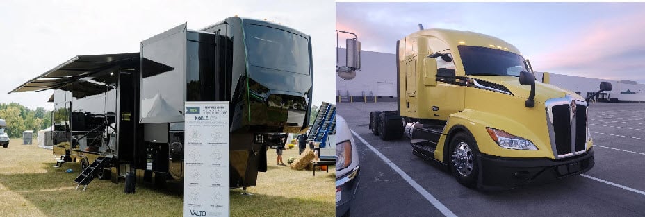

My Truck and new Axiom Vendetta 4250SP

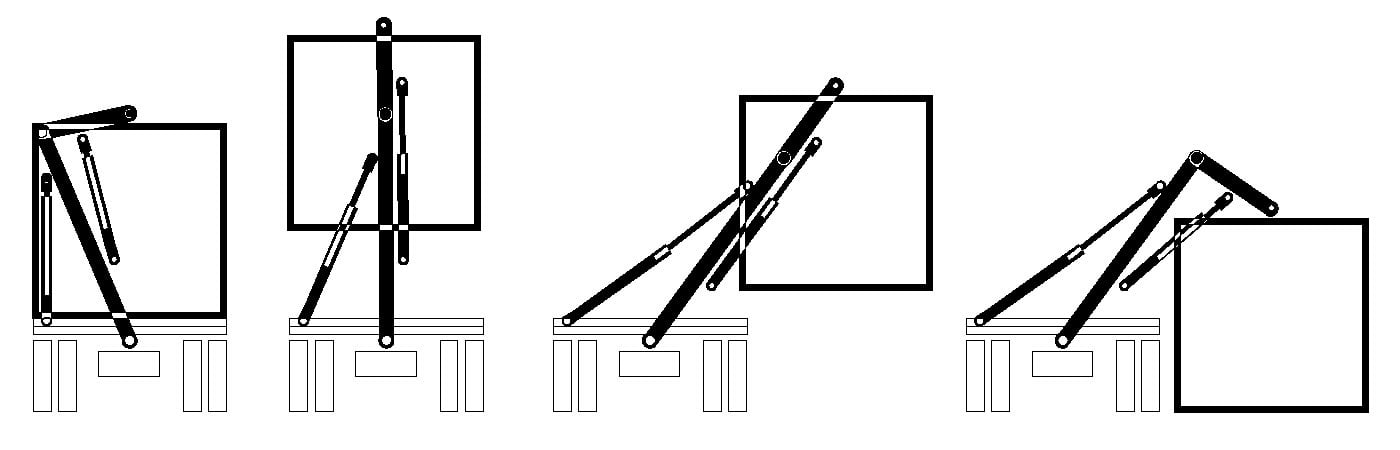

A CONCEPT drawing of how this pod will be loaded and unloaded. One arm assembly up front, and another at the rear. The pod is suspended from a round bar that crosses over the top center. I do not have the actual DIMENSIONS yet. Two pairs of synchronized hydraulic cylinders will do the work.

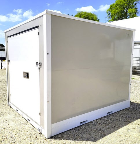

An example of the garage pod… It will be lifted from the roof.

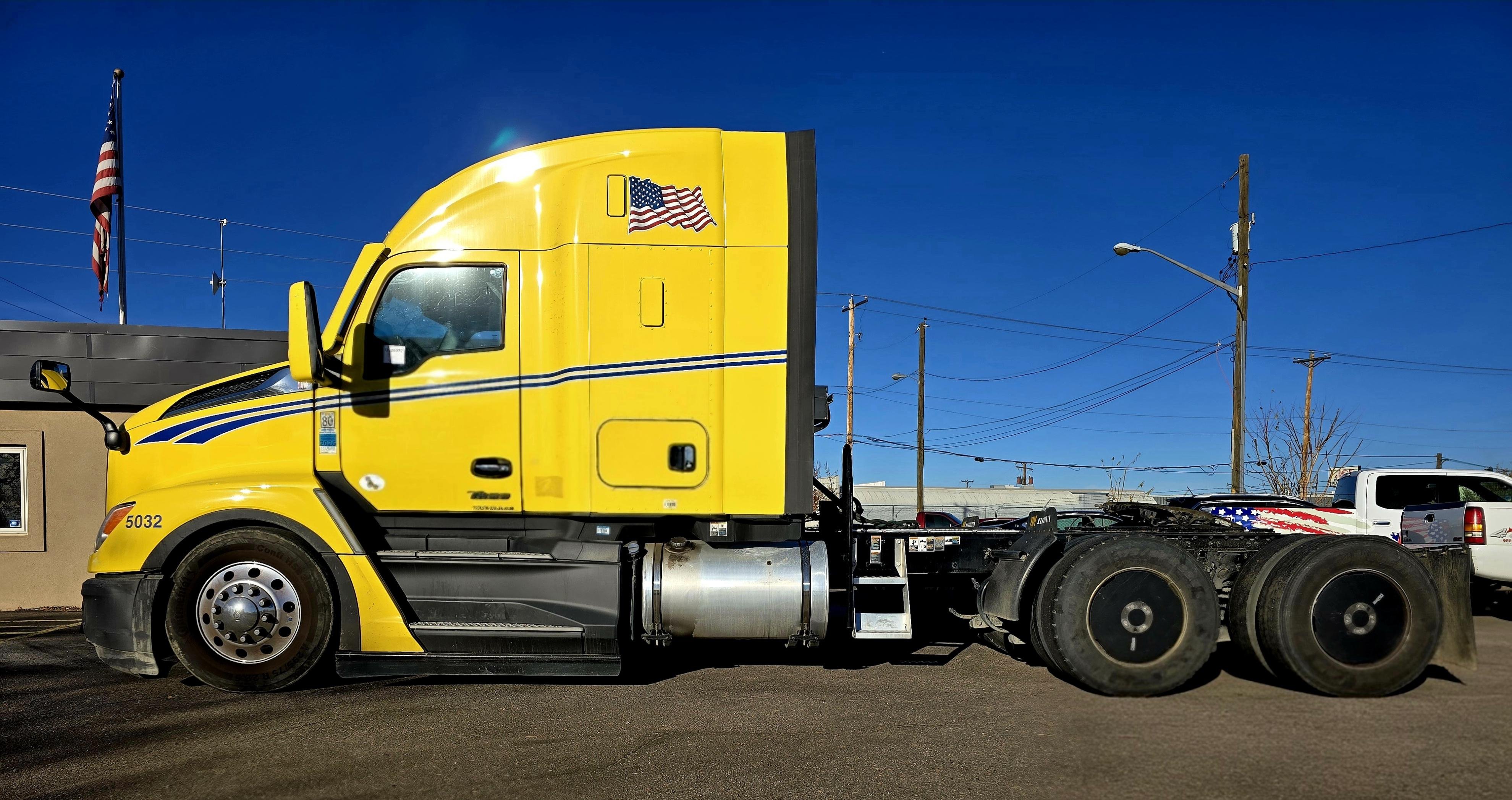

My truck - side view.

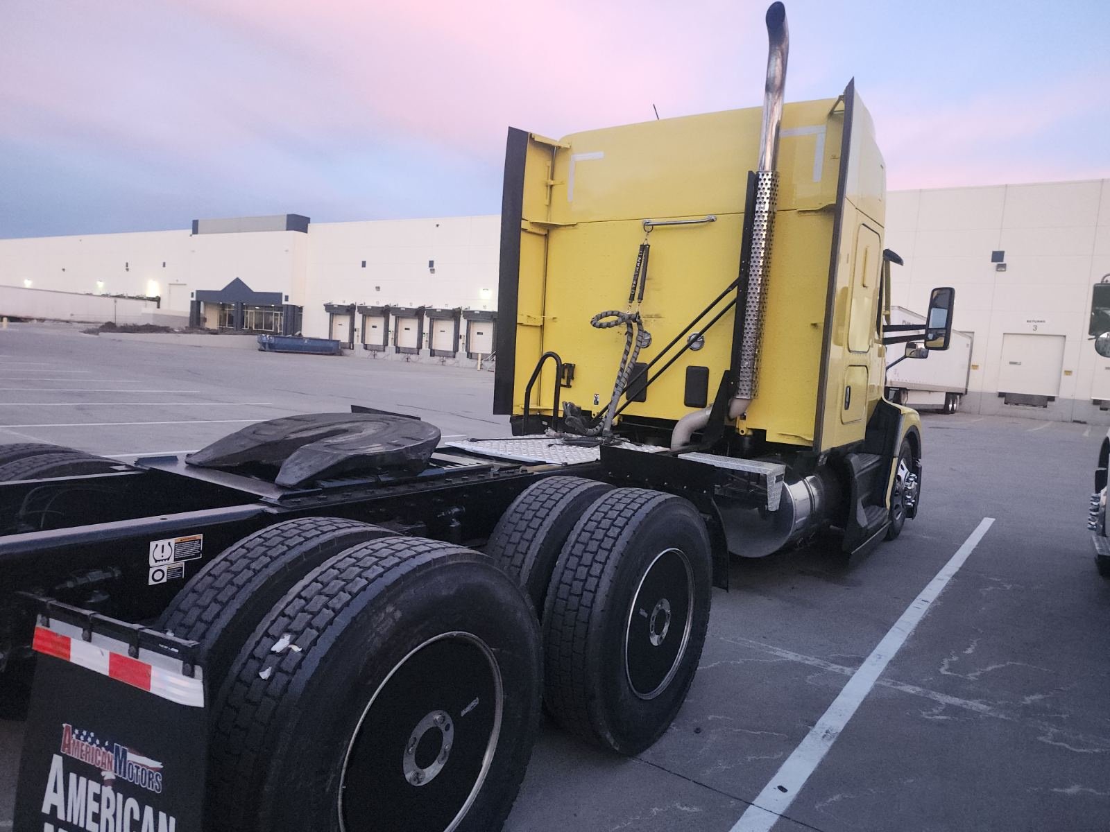

    This is the current rear view of my truck. The rear frame will be extended behind the wheels, and the toy hauler hitch will be connected there. So MOST of the area above the rear wheels is available… The existing Horse Shoe hitch in this photo will be removed. The TrailerSaver hitch will be installed…
