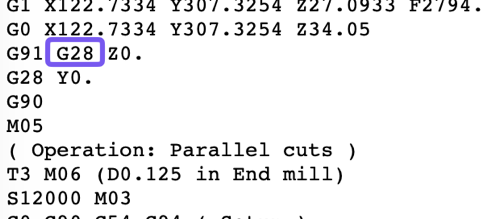

Here's the code before and after the tool change. Is the
( Setup )line starting the rapid movement toward work coordinate system 0 that results in tool breakage? I'm not sure, g-code is still new to me.Reviewing this gcode step by step, I'm becoming convinced that the error lies in the machine itself, not in the g-code. I have opened a ticket with support to discuss this issue - it makes more sense to me to reference X0 and Y0 from the current work item, but Z0 from the machine (at least, with the generic Masso controller set up).
There's a possibility that static build up cause the machine to become confused about its current location. I haven't seen this happen since I replaced the original Carbide3D controller with the Masso unit, but it's entirely possible. I'll report back after an attempt tomorrow, but with more grounding than I would have thought is needed.
My money is still on g28. It happens to about every hobbiest (me included). The cam puts it in there because the pro machine controls and operators understand it and are expecting it. Us hobbyists are not.

I don't have an answer for why this keeps happening, but it does. The issue occurs on the third line down from
( Setup )(line ending in F254:Is there a way to force CAM studio to move toward the work piece in just XY then followed by Z? That seems significantly safer for rapiding into my workpiece.
