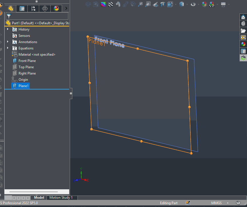

    - Pretty much everything is parametric in Onshape in a way that you would think that SolidWorks should be. Recently, I've been using variables a lot to drive my models in both SW and Onshape. In SW, you can't enter variables or equations into the input fields for some features. Ones I've run into so far as Helix, Plane, Scale (and others, but they escape me). The workaround using Instant3D is really frustrating and also doesn't work with Scale. It also gives you an potential circular warning error sometimes when there is none.
