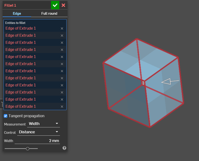

I am trying to make a dice, where I want to round (fillet) all the egdes. But I get this error:
There is a tutorial video, where the user just mark all the edges → fillet = it just works (https://youtu.be/cUe2O_85zIM?si=cDm09JQWSgZQ7HUJ&t=71)

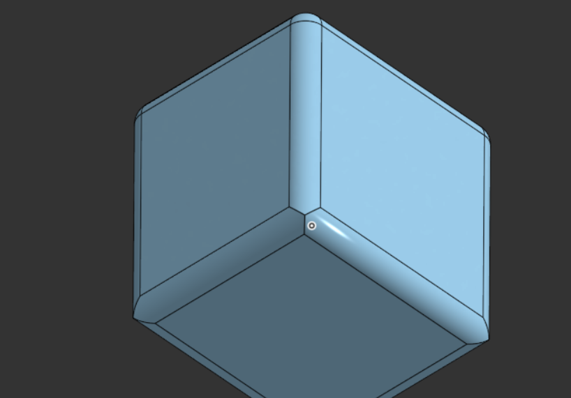

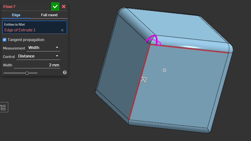

It looks like, that is not a feature anymore. However, I can do multible Fillet commands and do one for each side. But it is nbot doing it correct. By clikcing one line pr. command, the top looks correct:
But the buttom is off:
Furthermore, it does not allow me to do the last line?

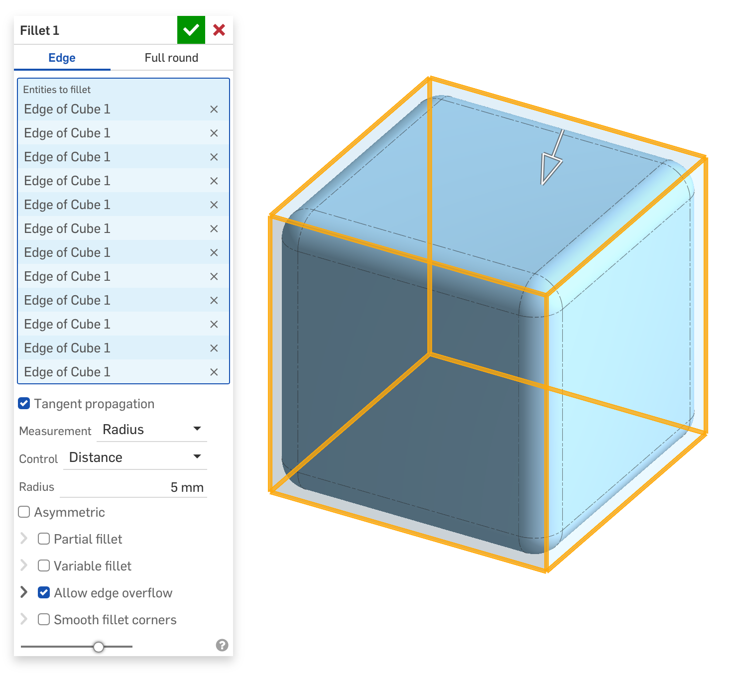

In your screenshot you have "Measurement" set to "Width", which can be very useful, but in this situation that's why it's failing. You need it set to "Radius".

The top fillet in this part is set to Width and 5mm. The width is the chordal distance and drives the size. The radius value is a resultant.
