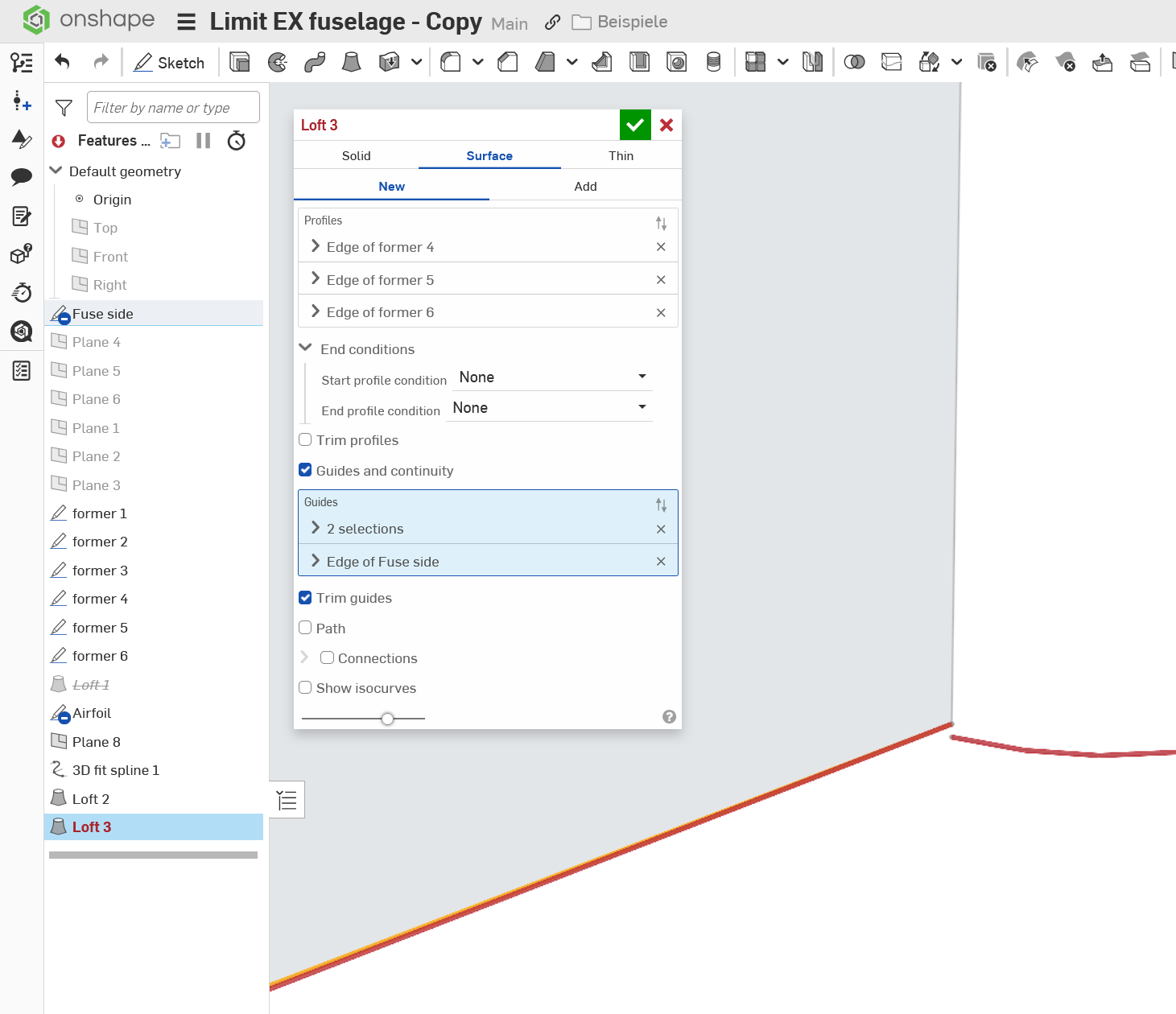

So this is where I am….a fuselage half I'm attempting to loft. I cannot get it to follow the splines defining the edges of the "Fuse side" sketch. I'm actually happy with it behind former 4, the way the top line ended up being curved. A happy coincidence. The issues are mainly ahead of former 3. The top surface between formers 3 and 4 will be removed when I cut the wing saddle, so even though it looks a bit odd it's probably fine.
Any pointers are appreciated.
Also, if anyone can tell me why the "former 4" sketch is undefined when the nearly identical formers 1, 2 3, 5 & 6 are all fine, it will save me pulling the last of my hair out. Constraints and getting sketches defined has been a major roadblock for me. I understand the principal but end up with blue or red lines anyway. I end up throwing random constraints at it or selecting the whole sketch and applying the "fix" constraint. Sometimes that works!

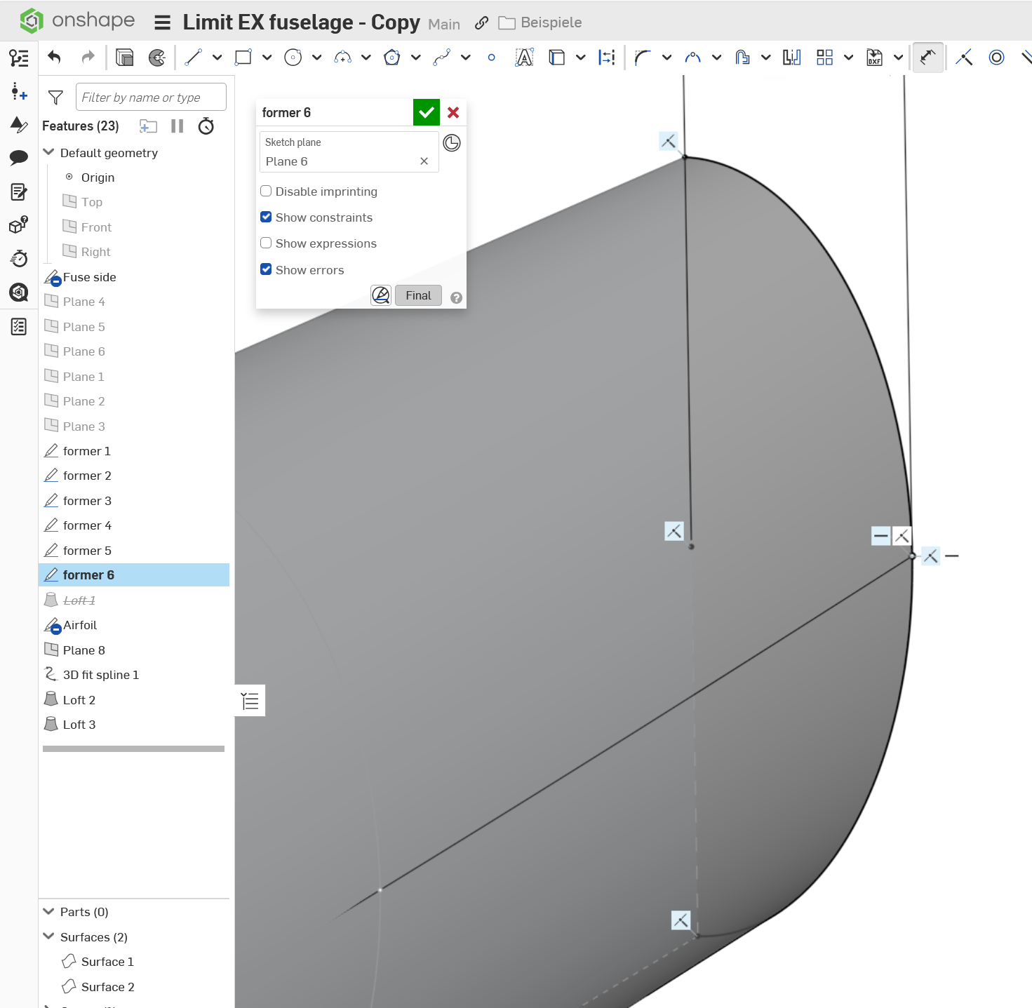

    Former 3 and 4: End point is not constrained to the origin, even it is positioned very very close to it.
    Close-up:
    Using the "Fix" does lock them in place, though not necessarily to THE place. ;0)
    Try not to use the "Fix". Else, the loft may find the curves you use do not actually meet, so it can't ctreate closed surface:

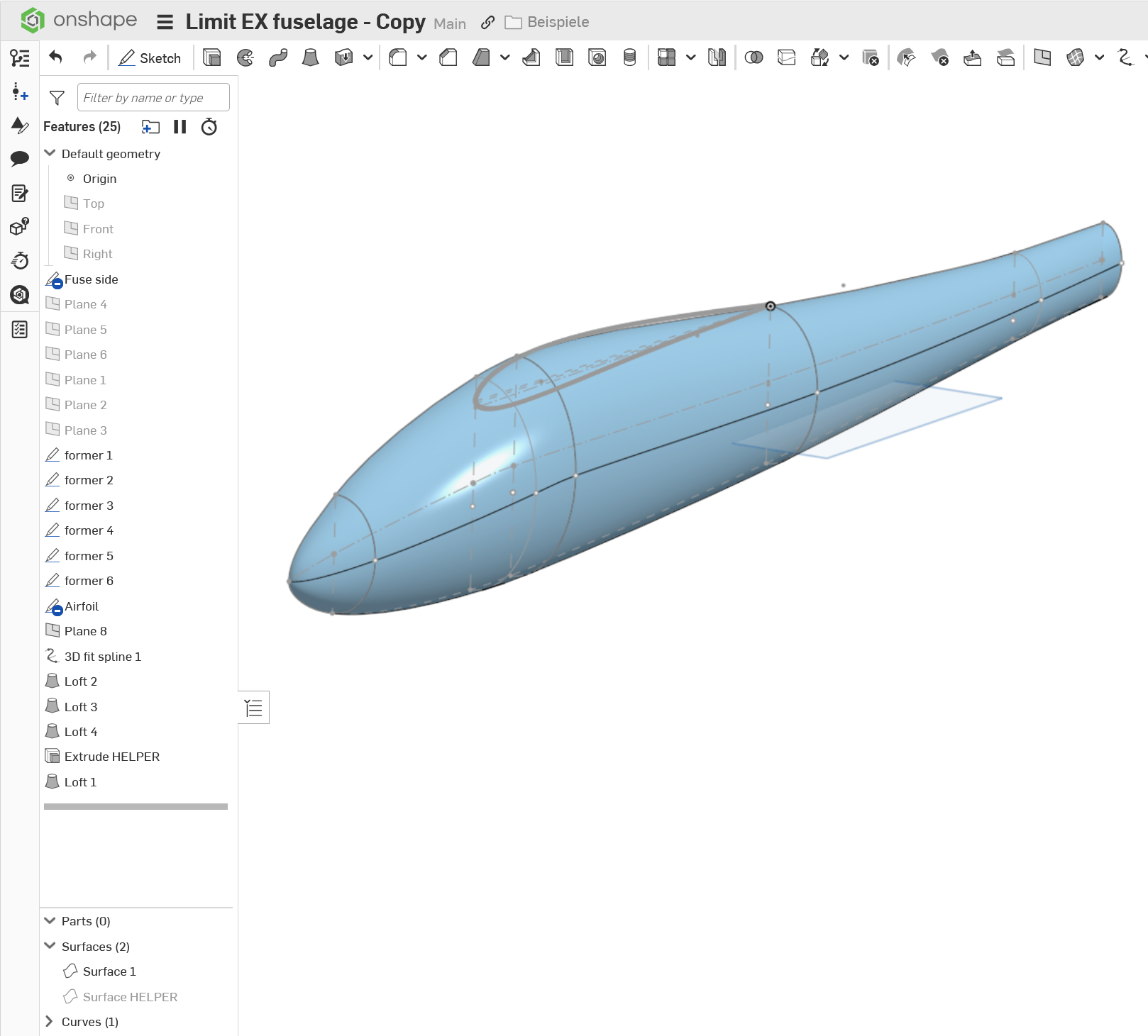

    After fixing that, the loft works:
    This model can be made to work, but I suggest you go through the surface modeling excercises in the learning section. You did not pick the best approach from the start, so you end up having avoidable troubles.
    Try to start with the larger image. Visualize the general shape (E.G. by 3D curves as seen above) before attempting to create formers. Make the shape first, add details like elevator mountig surface (much) later, and so on.

    One more hint: If you model half of the fuselage (which I recommend to save on work and reduce the error rate), create some helper geometry to help with tangency after mirroring the other half. Look at what I did with the nose: There is an extruded surface that is only used to make sure the two halves meet smooth and with no bump at the mirror plane. Good luck!
