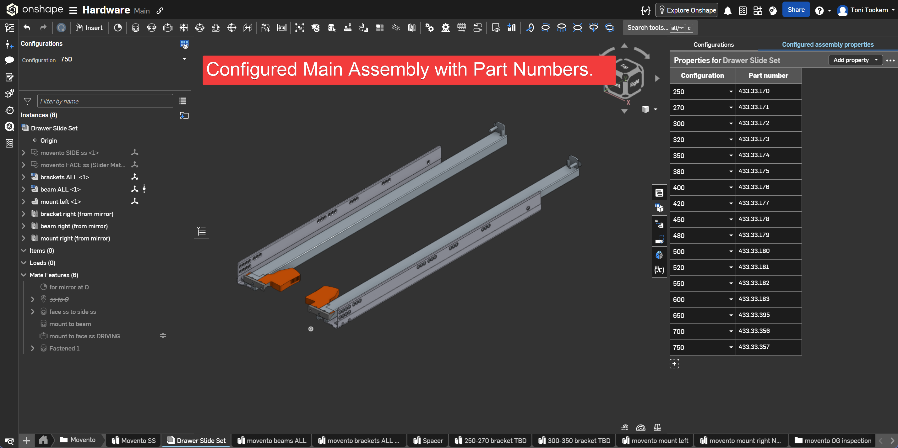

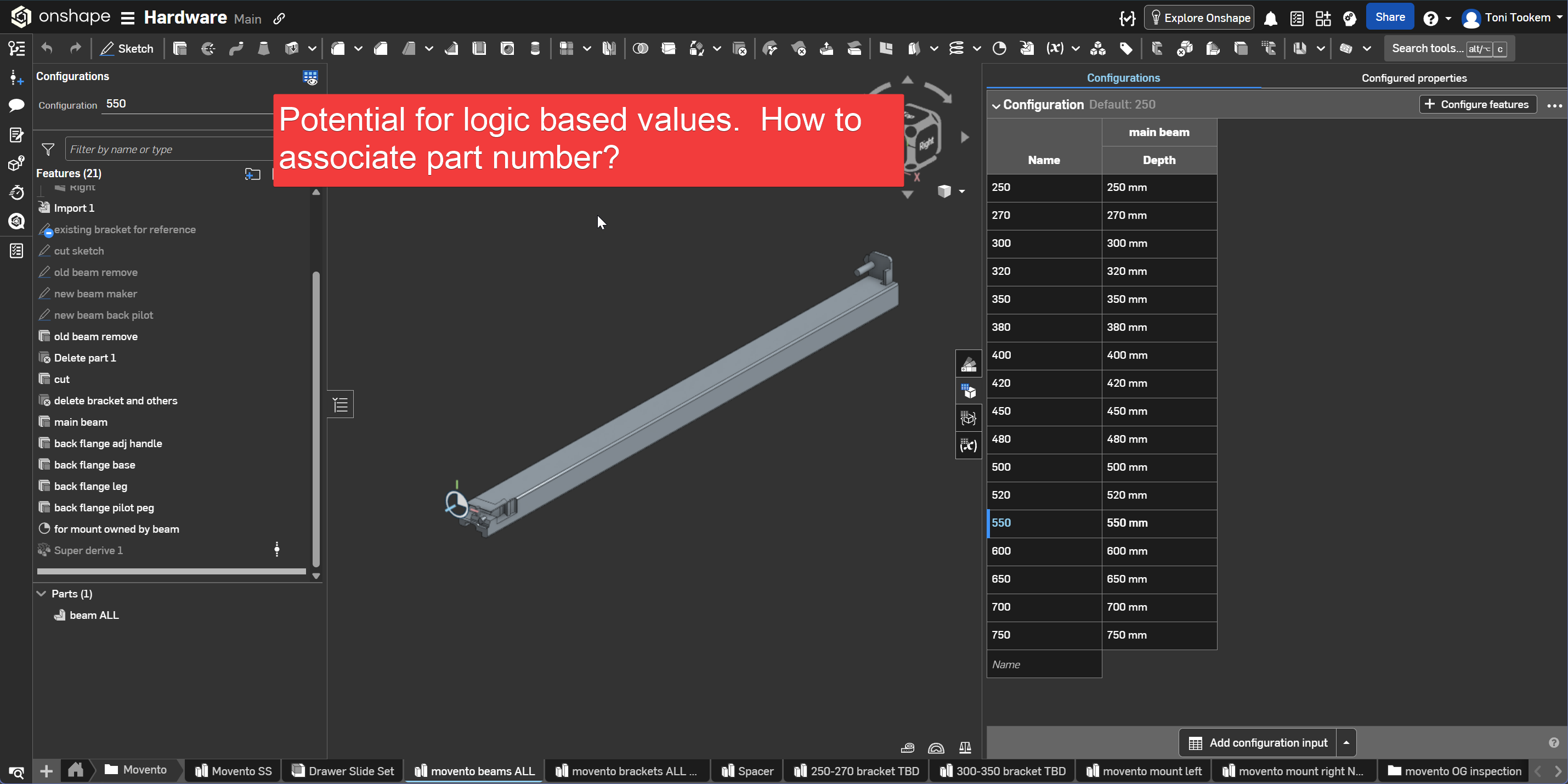

    I thought changing config is the only way to get the part number to the BOM. See screenshots. I can share this doc with you directly if it helps.
    The beam is controlled by values and brackets and mounts are imported geometry. Lets forget the imported geometry for now and focus on that how does one assign a part number to eg 750 value for the beam ? Then we can pass through ONLY this part number to the main assembly.
    BTW drawer slide depths Increments are not equal. They differ 20mm, 30mm and 50mm depending on specific part number.

    I see. In your case, why not just configure the depth value by the configuration drop down so no one ever gets the chance to try #DEPTH = 323.599283mm? You can limit selectable options to you list of values. That way you could also configure the part numbers as you're doing now.
    If that isn't going to work, you can actually set the PN with a custom feature too if you want to go that route, but it's more complicated, and I'm not currently seeing the point of trying that here based on your example.

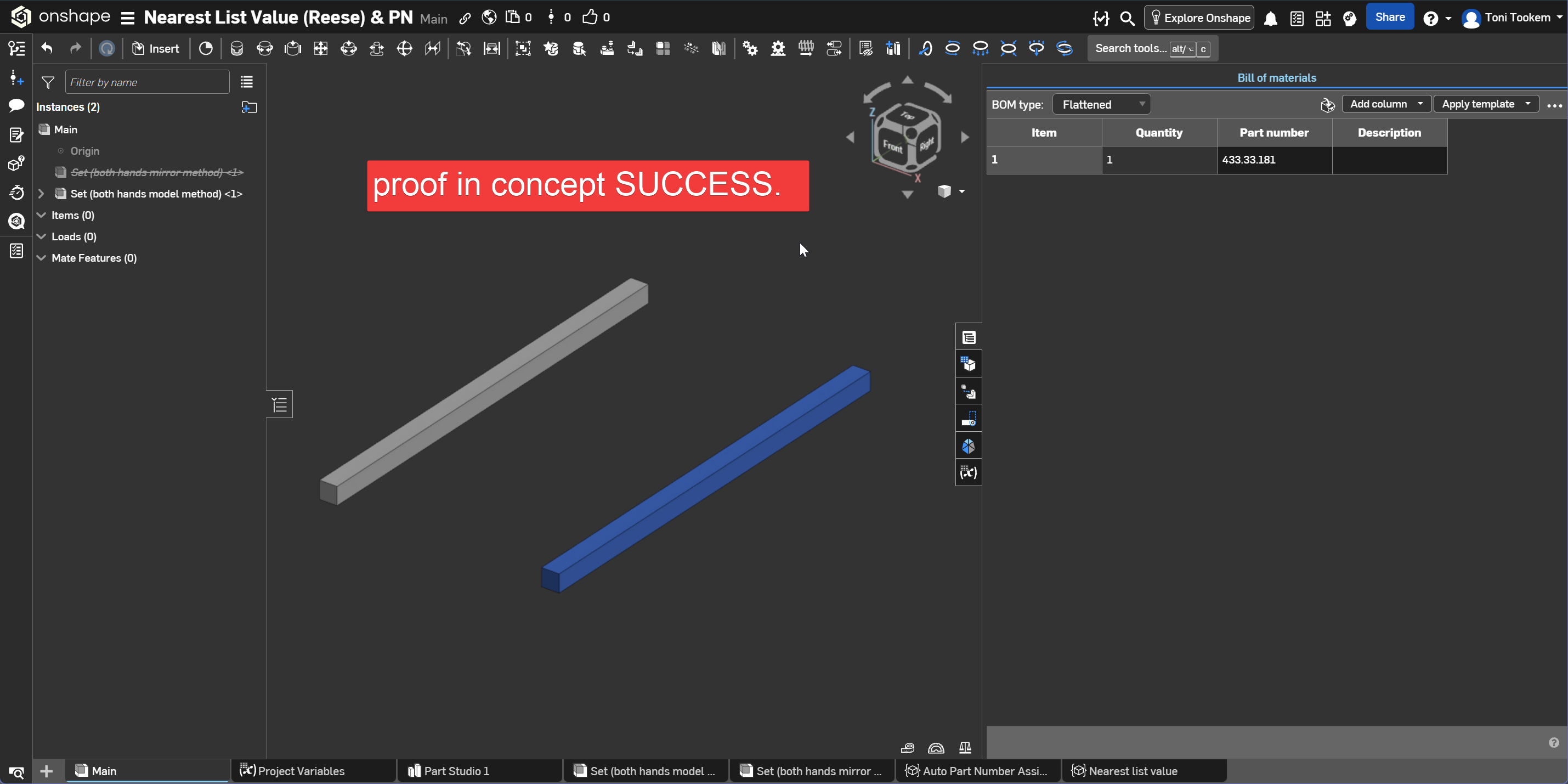

    Thanks @EvanReese for the " Nearest list value" FS. So I took it to the next level with a "Auto PN Assignment" FS. (Thanks to Claude Sonnet 4.5)
    Here are the results:
    https://cad.onshape.com/documents/9625b82998a2f86e9f23a403/w/6dd35be56d16cb9825eadc4d/e/7ac9b05c5786e987a49652b6
    I've built out a bit more a complete workflow for testing so you would adjust "Project_Depth" in the variable Studio.
    I think it's convoluted process whereas I'd be much more straightforward to just have logic configuration switching at assembly level but for now I guess this is work around.
