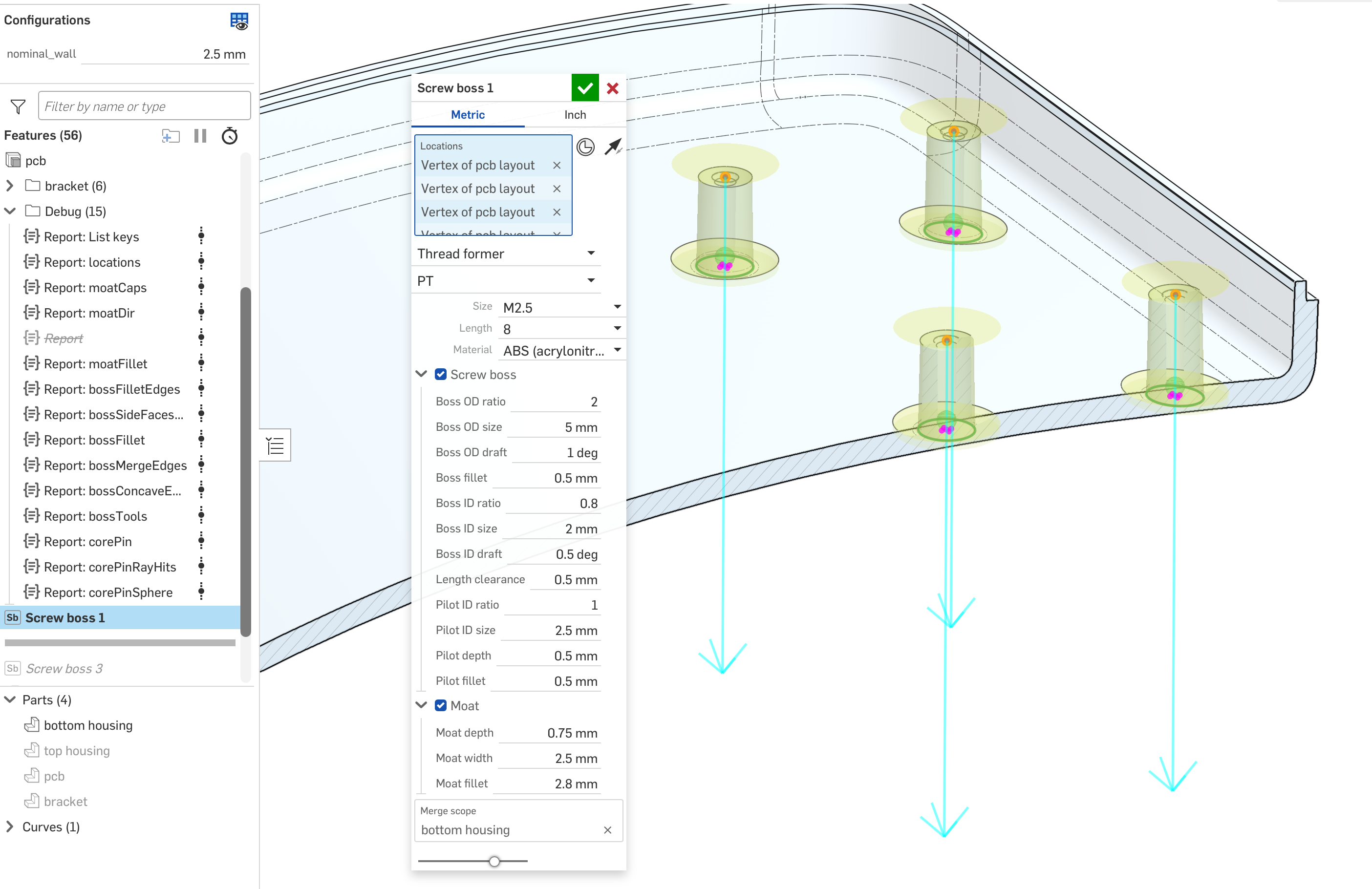

    Would there be an easy way to optionally make the viz() entities persist even when the feature in question is not being edited (through a toggle in the report feature)? For instance, I'd love to show the control polygon of a feature I'm developing while I'm editing an earlier feature with "Final" turned on. I could write a feature to draw control polygons of selected curves I suppose, but I wonder if there's value in persistent viz() stuff on screen?
  • jnewthjnewth Member, OS Professional Posts: 101 PRO
    That's a good idea, @S1mon - I can totally see the value. The simplest implementation I can think of is as you suggest but unfortunately leaves a lot of artifacts floating around in your part and curve lists.
  • S1monS1mon Member Posts: 3,943 PRO
    Another way to solve this is obvious in retrospect. I noticed in the last few videos from @GregBrown that he's adding test cases as configurations to inputs before a feature in development. This allows you to easily see whatever feature feedback (including viz/dbg) and things like analysis tools (e.g. curvature, or zebras). With configurations, it's easy to cycle through various inputs and see if the feature is still working.
    Say I'm testing a feature like my Edit Curve Plus that takes a curve as an input and can edit them through various control point modifications. I haven't done this yet, but I can imagine getting ChatGPT to generate a table of inputs to drive input curves with all kinds of crazy orientations and parameters. It wouldn't quite be automated fuzz testing, but at least I could quickly cycle through a lot of potentially problematic inputs.

    Just wanted to bump this thread and say that viz(), dbg() and the Report feature are really making my life a lot easier.
    I've been working with Codex to develop some complicated geometry, and I'm playing product/project manager and product tester. I can give it screenshots, but AI still doesn't understand spatial things that well yet. It understands the math behind geometry, but when it gets a sign wrong and something is flipped it's much easier when I can tell it to add viz() or dbg() to a step so I can see what's going on and tell it to fix the issue.
    BTW, I really love telling Codex to add the viz() things and it comes up with reasonable names. It's silly, but so much time coding is just thinking of what to call everything.
    Glad you're getting use out of it! I have also found it very handy for debugging complex geometry FS, because you want to visualize a lot of stuff but not always the same set and not at the same time. And removing my printouts and visualization is generally a thing I eventually have occasion to regret (when yet another test case breaks). Once you switch over to viz and dbg you dont have to worry about it - just add everything, it's fine.
    In my case, Reframe is building a large FS codebase of libraries and custom features used across hundreds (? maybe thousands) of documents. When custom features fail in the field, I dont have to create a doc to then debug or recreate the feature with a 'live' version of the code in order to add printlns and debugs to — I just start sticking Report features in to see what is happening under the hood. It has become a huge help for me.
    Makes me happy to hear you're finding some success with it @S1mon. Finally working on that (awesome) plastic boss feature we discussed ;)
