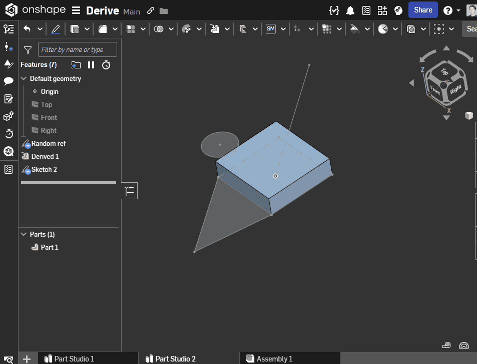

I get some weird behavior when changing the location of a Derived part that is Use'd in a sketch. All my Use constraints are broken. Steps to repro: (see Part Studio 1 and Part Studio 2 for an example)
  1. Define Part 1 in some Part Studio
  2. Derive Part 1 into some other Part Studio (e.g., Part Studio 2) and set the location to be some vertex
  3. Create a sketch in Part Studio 2 and Use a face of the derived Part 1
  4. Add some lines in the sketch that connect to vertices of the Use'd Part 1 and complete the sketch.
  5. Edit the Derived feature and change the Location to be the Origin (likely any other location fails too) and complete the feature edit
  6. Notice that the sketch containing the Derived Part 1 is now full of unresolved references for all the Use'd elements of Part 1.
What have I done wrong? Is there a way to update all the references? Is this a bug? Seems like a major limitation of Derive/Use if the Derive feature Location can never be changed once added.

    The key is to edit the derive correctly:
    • If you clear the selection and pick a new point, it a "different" derived instance and it will break the relations
    • If you edit the mate connector in the derive feature to a new position, the reference will follow:

  • jeff_mcafferjeff_mcaffer Member Posts: 98 ✭✭✭
    🤔That certainly did it. Thanks. My problem was that I accidentally picked the wrong vertex for my mate connector when first creating the derived part. So, "naturally" I was deleting that mate connector and creating a new one. Editing the existing mate connector is the key. Thanks again. The Onshape community continues to amaze and impress.
