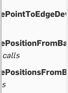

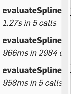

    One thing that's particularly frustrating about the profiling tools is that there's no way to extract the information from the side bar or expand it. I have to scroll left/right to read anything. You can click on each item, and the editor jumps to the function call in question, but there's no good way to copy this data into a hit list of stuff to work on.
    These are 3 different functions, but because of how they're named, it's tricky to see the info:
    If I scroll to the right, then I can't see the timing info:
    (one could argue that the naming could be abbreviated to account for this limitation, but should we have to?)
