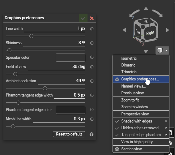

Is there a way to adjust the perspective as seen in SW? Currently, my project does not look right in 3D in a non-perspective way, but putting perspective on distorts so much that the object looks 20 meters long, while it is only 2 meters. In Onshape, to date, I have not found a solution. Anybody?
If it is not possible, can it be please added to the list of improvements. Thanks, Gerard

RenderStudio isn't in the free version, but the perspective adjustment is available to everyone!

Yes! I believe it was a release or two back. Camera and render options → Graphics preferences → Field of view

Exactly what I was looking for, the 'Field of view option', Which works with Perspective View.
I overlooked this. It would be great to have this option also added under the Perspective View option, so it is easier to find.
Thank you so much for showing this to me.
