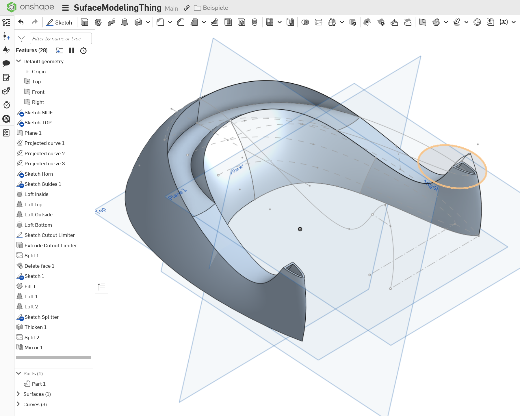

Sometime ago i decided that my speaker base was ugly as gray and wanted to 3D print it in black. Problem is, I don't have a 3D scanner, just Onshape, my trusty caliper, and a braincell or two.
What I created was a monstrosity of variable fillets with lots of model errors. The print came out clean enough and it doesn't show all the defects in black, but I'm curious to see what other tools in my toolbox I could've used to model something like this with more accuracy.

That is actually a rather easy one. Your approach wasn't quite spot on, though, so you may want to look into surface modeling in the leanring section.
@omar_omari
A quick sample, lacking all the dirty details, though maybe you get the idea:
https://cad.onshape.com/documents/298b24b3cbc8127a0fbb66d4/w/19bed4993edd61608781bed6/e/610328b93c9a32a80ed2b641?renderMode=0&uiState=698de423de00804378ca1f24
Just to prove it could be done in principle.
A shape like that is usually made with curves and surfaces. It's not easy. Outside of professional designers/engineers making injection molded parts for consumer products, (or automotive), I doubt anyone is going to spend the time to learn how to do it.
It's very doable in OS, but you would need to spend a solid week learning the curves and surfacing courses, then practicing them. Besides learning the CAD portion of it, you need to learn how to conceptualize "where" the curves should go to get the shape you are after.
