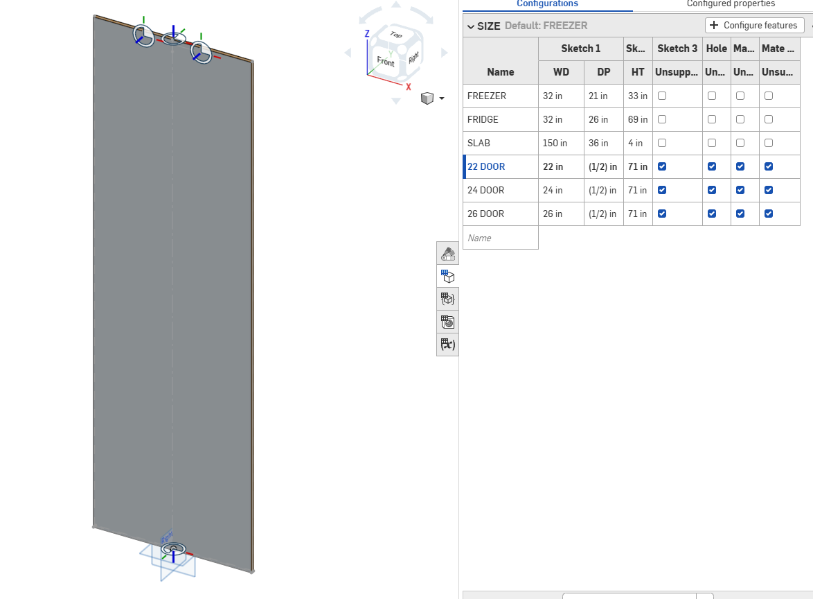

Configured unrelated cubes as parts in design, figuring I'd just rename instances a la SW.
But renaming configured instances does not appear to be possible in OnShape, true?
Problem is all instances show up in feature tree as BOX — is there any simple way out of this?
Or a more complex approach, perhaps like branching BOX Configs Part Studio to say PANEL, SLAB & APPLIANCE Part Studios?
What, if anything, can be done to differentiate w/o breaking (and thus needing to re-define) existing mates?
Thanks in advance!

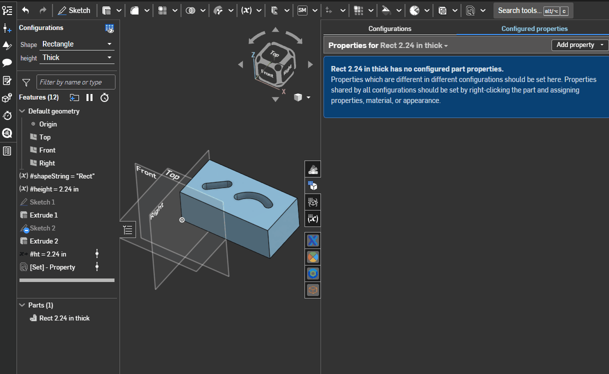

Go to the "configured properties" (top right when looking at the configuration tables) and add "name".
Or bring up the BOM view from the assembly level and rename things there, it will create entries in the configured properties (as long as it's a workspace reference).

The Name column in:
PART STUDIO CONFIGURATIONS…
…doesn't match the Name column in
PART STUDIO CONFIGURED PROPERTIES
(instead matches the SIZE column)
Can live with this for now, but that'll be a problem going forward!

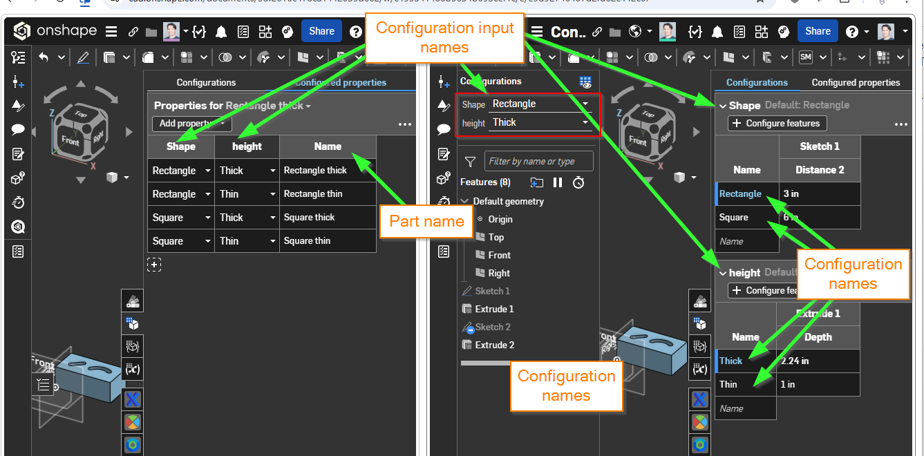

@brandon_nichols678 , the "name" column in the configuration is the name of the configuration itself. The "name" column is the configured properties is the name of the part. The difference becomes more obvious when you have more than one configuration input (something that doesn't exist in SW), not sure if you've used that yet… The configured properties will have a column for each configuration input on the left so that each line in the configured properties describes one combination of configuration inputs.

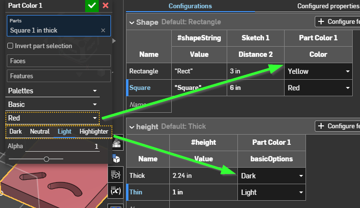

I would also highly recommend using the "part color" FS as it is easier to manage than through configured properties:

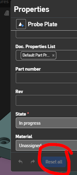

One last thing to be aware if you go this way is that you will need to "rest all" (in the properties) for the property/attribute and color FS to take effect if you have manually set part names and appearances.
