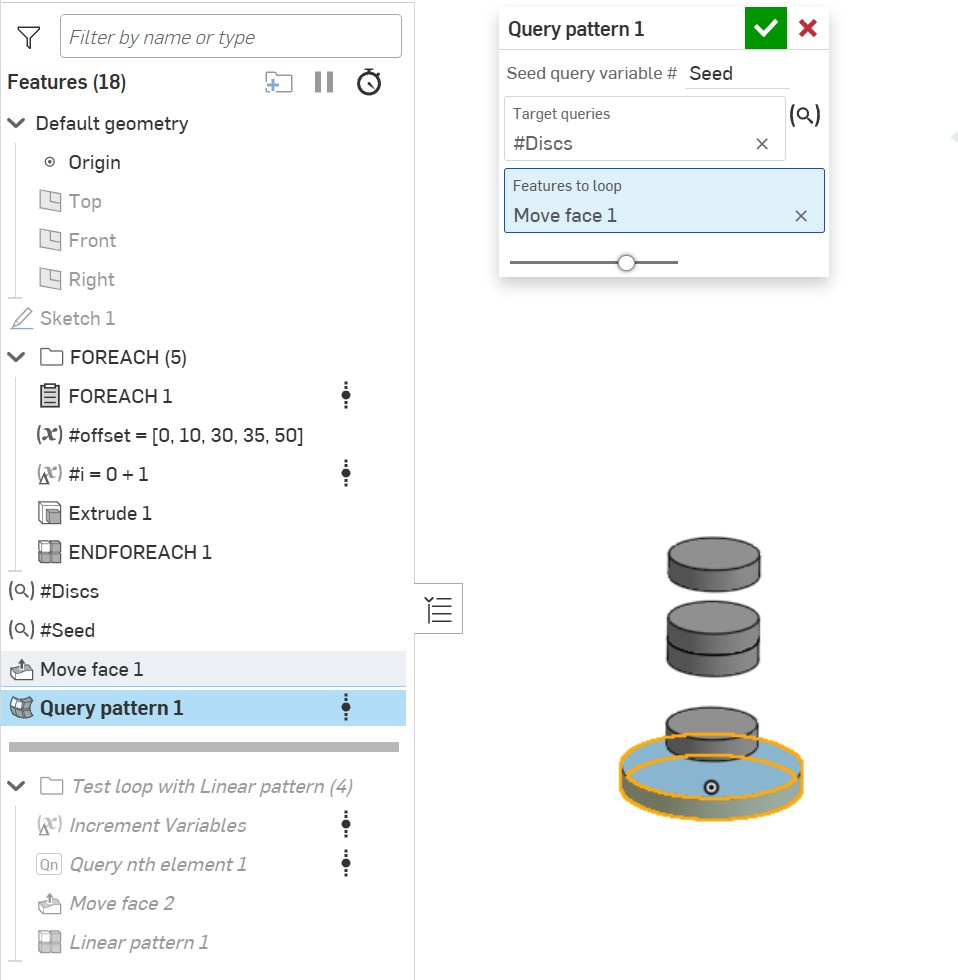

    I might have run into some limitations here. At least, I couldn't make Query Pattern work with Move Face. I have created a very simple example in which I do a Move Face on the cilindicar face of a disc, and then, I try to repeat the same operation on a series of discs with the Query Pattern feature:
    Interestingly enough, if I try to achieve the same using the Linear Pattern-loop trickery you showcased in a previous video of yours, @EvanReese , it doesn't work with MoveFace either. See the "Test loop with Linear pattern"-folder: https://cad.onshape.com/documents/4a142ce31429dae12b75a3dc/w/6a2a2436caf0724cd2e8bba1/e/4d0d163eb0dbc691eee210ea
  • EvanReeseEvanReese Member, Mentor Posts: 2,845 PRO
    That's odd. I'm not sure what's going on there. I see you've already looked at the Query Nth Element feature, and if you cycle through the index there it works, but the pattern doesn't do it. I also found that Thicken works with the exact same setup. It really does smell like we found some edge case that (understandably) wasn't imagined/prioritized in the standard code. It feels like it ought to work.
