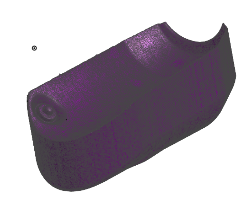

I've been importing meshes with no issue but I've made a couple of scans that I've used an extrude command on in meshmixer and mesh inspector to make a surface into a solid part. When I import these into Onshape I get a message they have imported and get a new tab but they don't show up in the part studio. When I hover over the tab there is a preview of the part and if derive the part into anther part studio there is also a preview of the part but nothing comes in. The base mesh before extruding in either mesh mixer or mesh inspector comes in perfectly so Onshape doesn't seem to like when the part is extruded and made into a solid. Is there something I can do to make it show up or is this a bug in Onshape? Any help would be appreciated…

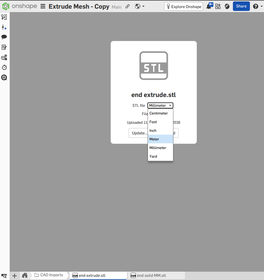

  • CADNurdCADNurd Member Posts: 88 ✭✭
    Update units from here - see below
  • lee_warwicklee_warwick Member Posts: 6
    Well, what a dummy, didn't even think to look at the units/scale as the original part that came in before was the correct size, so somewhere in the process of extruding the units got screw up. Mystery solved, thank you all.
