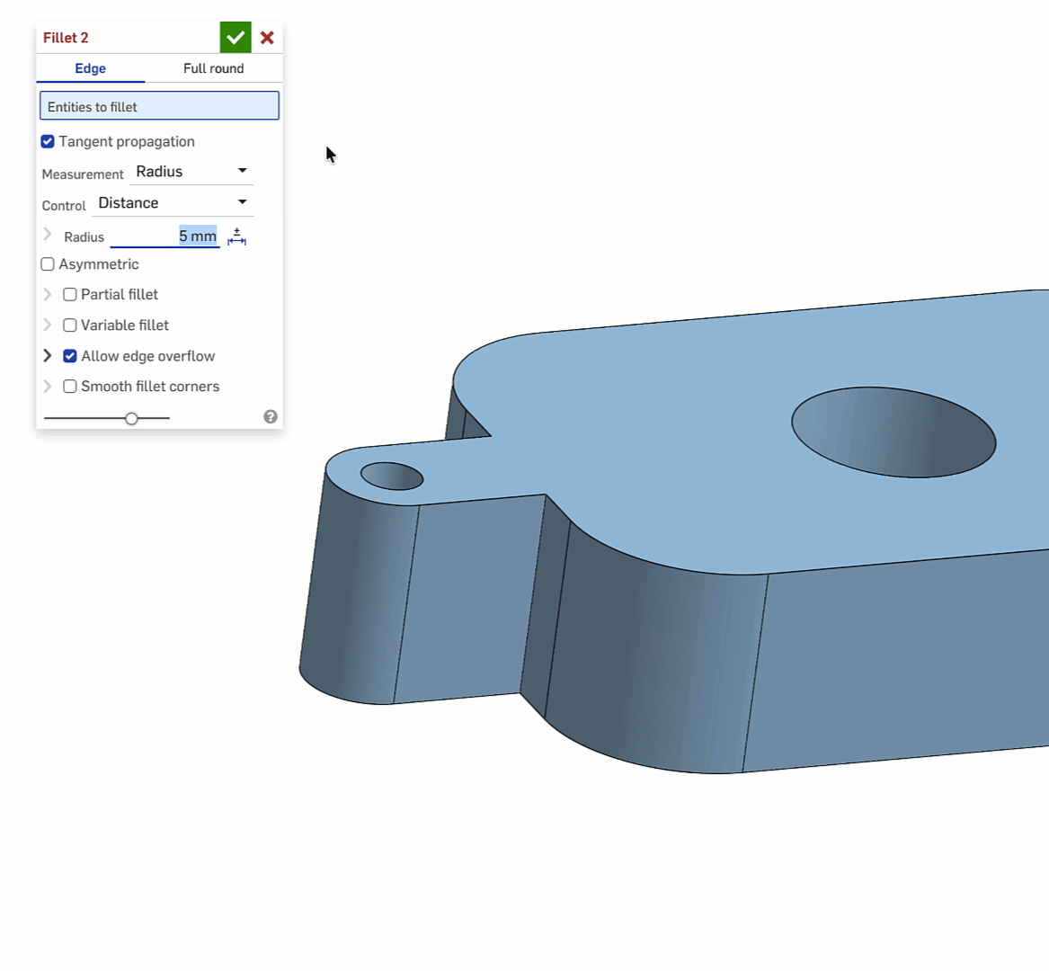

Remove edges from a selected face for filleting
Daniel_FristDaniel_Frist Member Posts: 2
Advanced OnShape user here. It would be nice to be able to simply remove edges from a selected face while filleting a part.
Selecting a face is fast, but I want to be able to remove the hole edges from the face.
This is an improvement suggestion. No workaround suggestions needed.
  • Matt_ShieldsMatt_Shields Member, Onshape Employees Posts: 941 PRO
    Sorry, I know you said no workaround suggestions needed…
  • _anton_anton Member, Onshape Employees Posts: 525 image
    Pretty easy to do this with a query variables - indeed, I'd argue that this is closer to the one true way than a workaround: https://cad.onshape.com/documents/c5dbc784cadc2b32d885adb7/w/1fa0ed3382b043b6fe411bf0/e/09b715421ad78c2bd376b4c2
