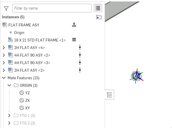

    On a previous topic, something that would really help me use a fastened mate instead of 3 planars for strut fittings is an 'XYZ gizmo' kinda-like the one shown by screenshot — comprised of 3 origin-connected mate connectors, each placed on an ordinal plane: XY YZ & ZX
    Tried making a part studio element out of these 3 mate connectors, and they don't seem to come across when inserted. Should they? Am I missing something? But I wouldn't need the block at all if I could reliably snap mate connectors to the center of a hole on each of the 3 ordinal planes.
    Can usually get XY and one (but not both) of the other two. Holding 'Shift' seems a crapshoot, yep I know how to move-rotate but is there really no keyboard shortcut to toggle forcing XY, YZ & ZX orientations?
    Might a feature script do all 3 with a few simple clicks?

    Mates are always Z-Z aligned of the two mate connectors. You only get the option to re-orient on the fly when selecting the origin of an assembly. Adding 3 MCs to the origin really doesn't add much IMHO. There is no FeatureScript in the assembly environment yet so no help here…
    When you are mating to other things you need to edit the mate connectors to re-align/adjust, it's a few too many clicks but it gets pretty quick when you are used to it and worth getting used to.
    You can't insert a mate connector from a PS directly in an assembly if it's not tied to "something", however I think you can make it into a composite part and insert that…
    There is one thing you can do that might work for you: if you setup MCs in a part and enable "snap mode" when you insert, you can mate directly and use the ctrl key to cycle between the MCs used for the part. See discussion and example gifs in this thread:
