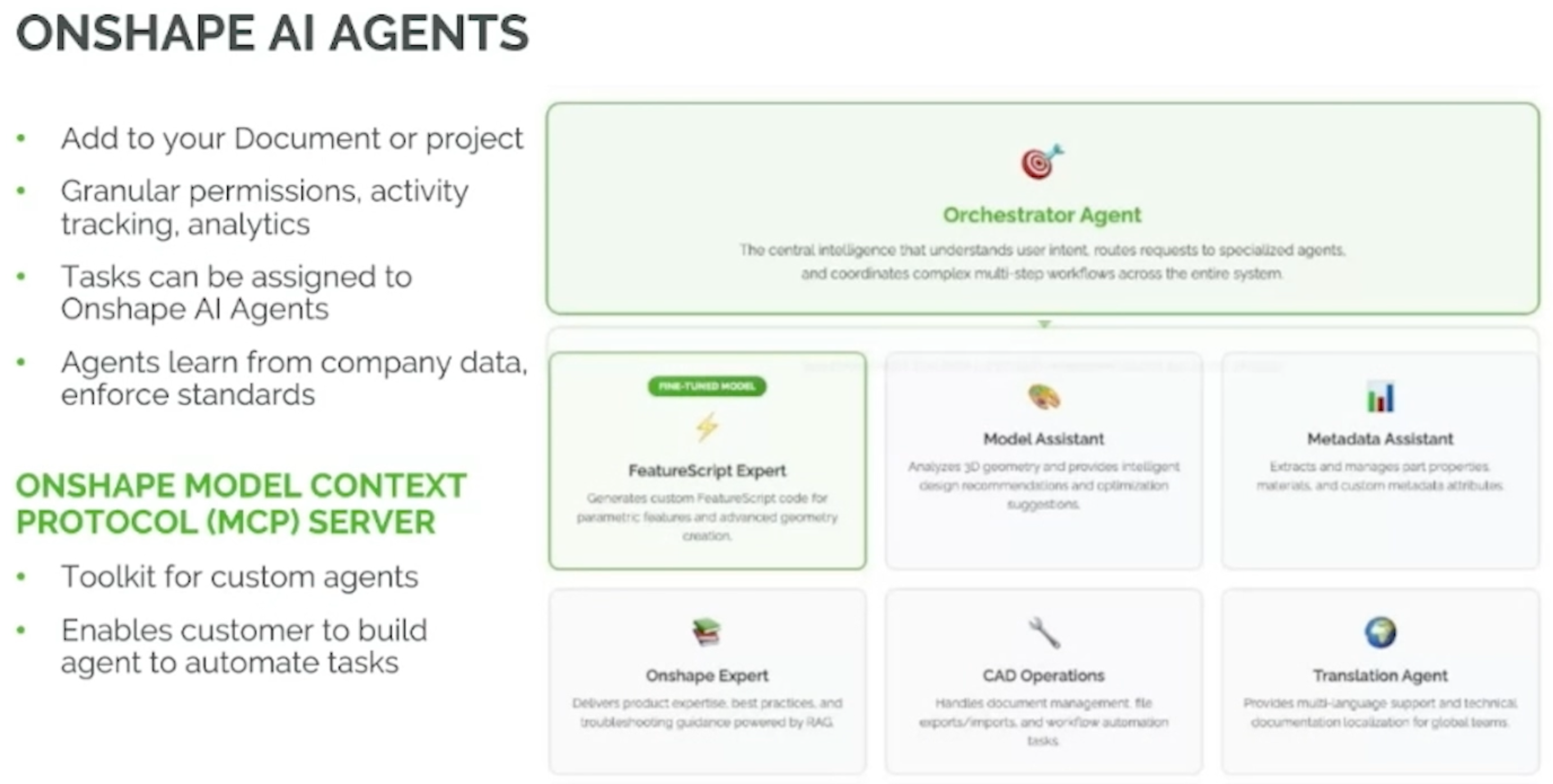

As I commented on LinkedIn, "I'm excited to see this step, but isn't this where Copilot was 4 years ago? I'm writing whole features using Codex/ChatGPT with local clones of the standard library and FeatureScript documentation for its reference. As Michael Pascoe commented, we need integration with the latest agents, ideally through MCP alongside the current IDE."

Here's an example of a major SaaS based design tool with MCP integration:
https://www.figma.com/blog/the-figma-canvas-is-now-open-to-agents/
Here's an example of chat driven CAD programming (Grasshopper in Rhino3D):

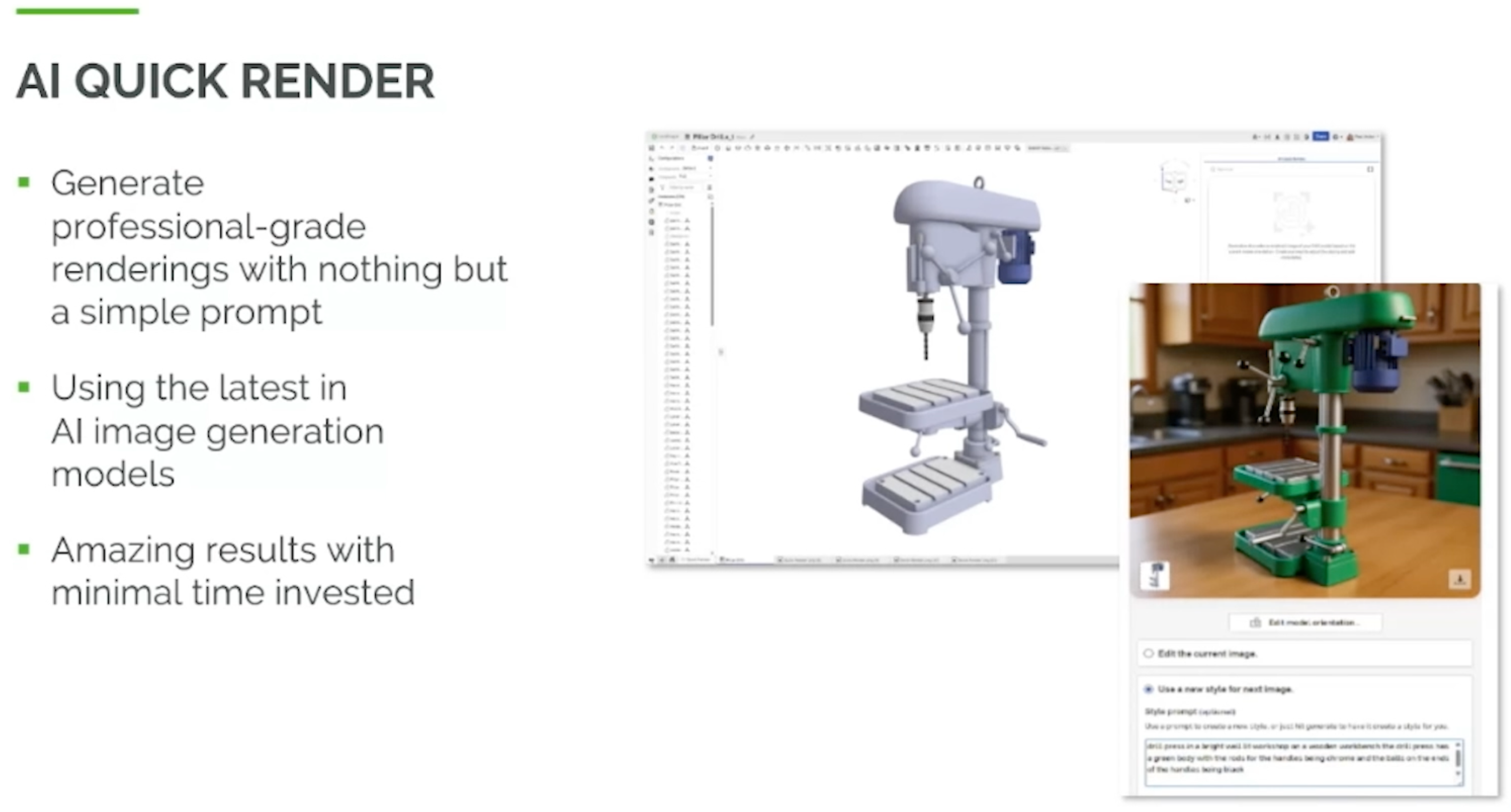

We've got AI Quickrender rendering coming (sorry RenderCAD, looks like you might be getting Sherlocked.)

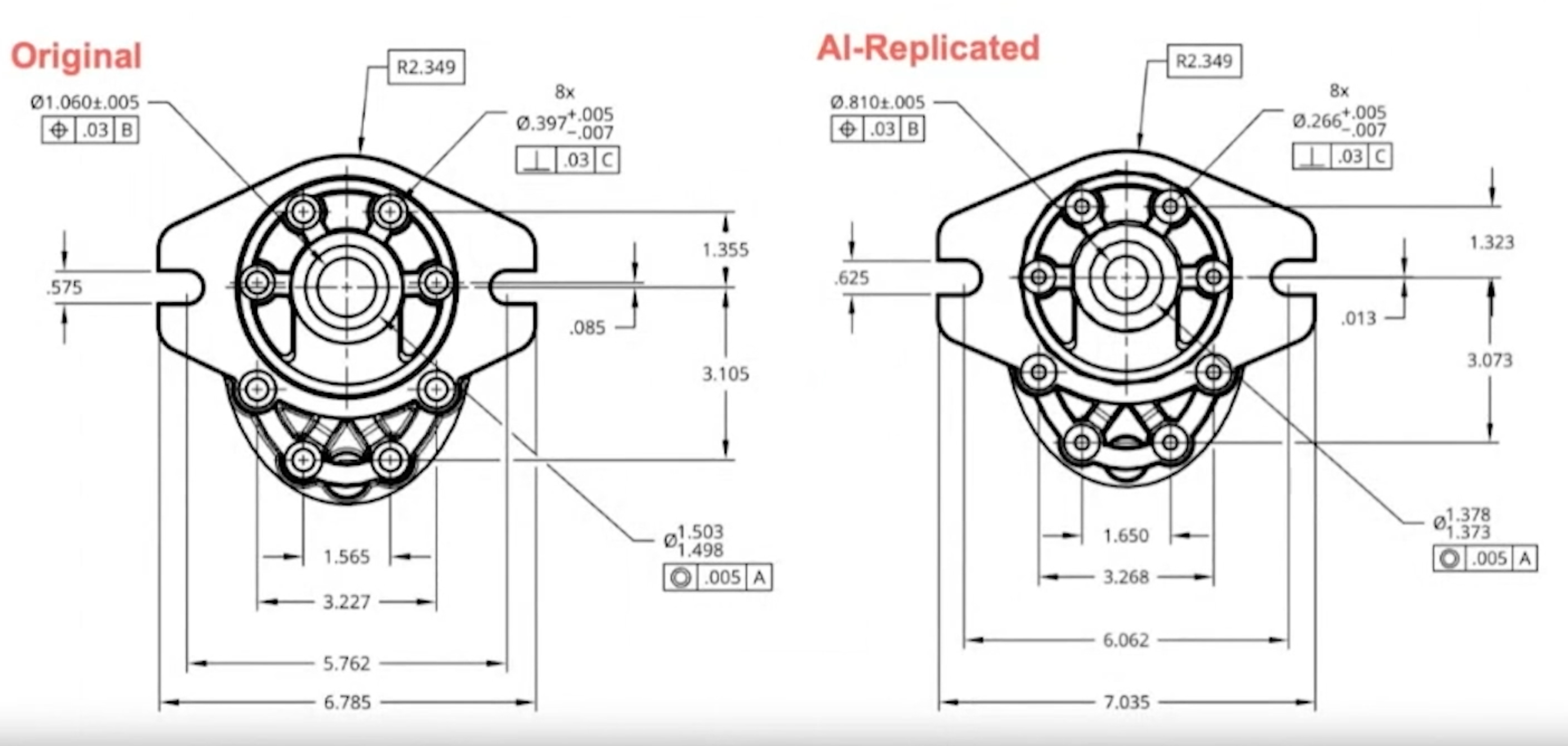

We've got some drawing annotation replication coming (i.e. tell the AI to look at a view on one drawing for part A, and apply that to the second drawing for part B) (sorry https://www.drafterinc.com):
And most important to me at least, AI Agents including one tuned on FeatureScript, and a general MCP connection:
