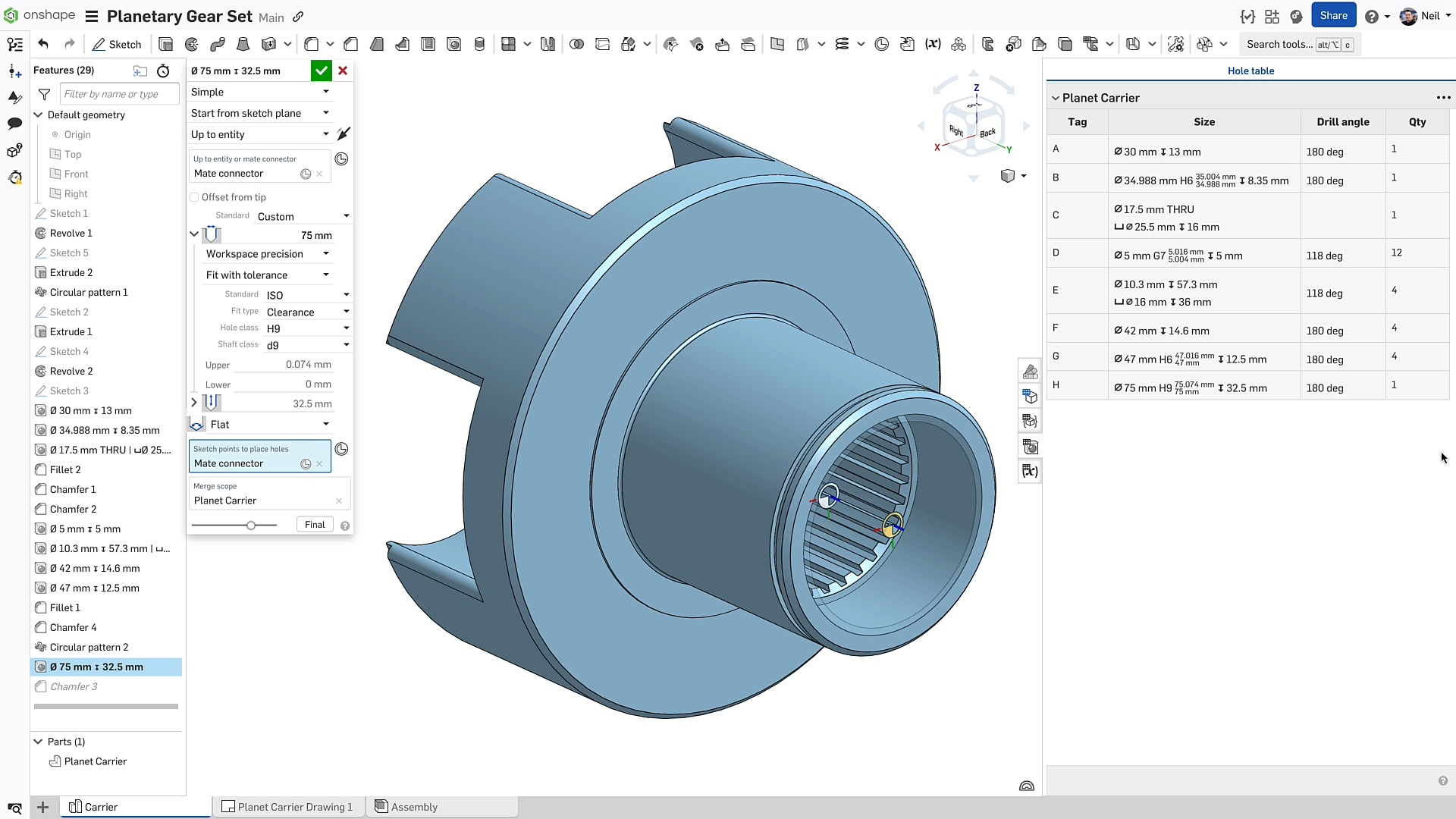

    S1monS1mon Member Posts: 2,365 PRO
    There was a big update in November which included this:
    What's New 1.173 - Fit Class Tolerances
  • Options
    PeteYodisPeteYodis Moderator, Onshape Employees Posts: 519
    We are also working on additional drawing tolerance tools to support non hole case as well as hole override support (important for references to a version where these were not defined for hole features).  The What's new that @S1mon posted above was really round 1 of the feature set.
