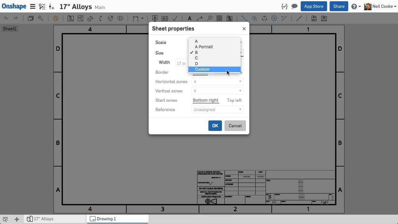

  • PeteYodisPeteYodis Moderator, Onshape Employees Posts: 578 image
    We've had custom sheet sizes for 5+ years now:
    Improvements to Onshape - May 24th, 2017 — Onshape

  • wayne_sauderwayne_sauder Member, csevp Posts: 651 PRO
    If you are dealing with CNC cutting why not send the DXF from the face of the part? (skip the drawing sheet.)
  • dirk_van_der_vaartdirk_van_der_vaart Member Posts: 561 ✭✭✭
    RMB on the face you want to export and select export DXF, same for flat pattern,s
