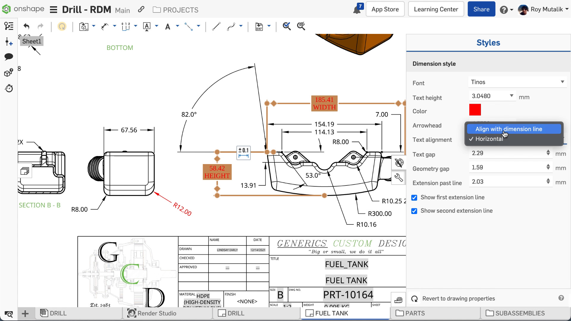

  • PeteYodisPeteYodis Moderator, Onshape Employees Posts: 577 image
    @Boice We released a style panel quite a while ago now and have updated many times as well:
    92827ad9925b8411339a25eabd1990f64f9035a9.jpg?image_play_button_size=2x&image_crop_resized=960x540&image_play_button_rounded=1&image_play_button_color=f88701e0
    Improvements to Onshape - March 14th, 2022 — Onshape
