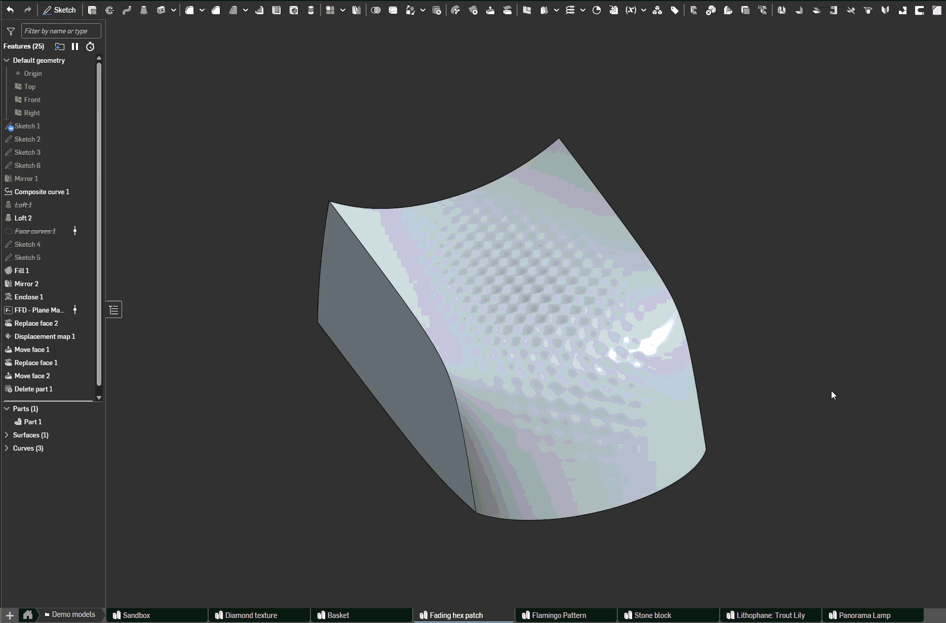

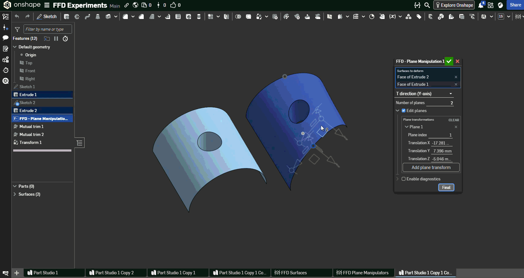

Ah to be a developer that can make tools that run without a feature tree, utterly unconcerned with build time. I'll definitely be stealing some inspiration from the Rhino UI for the final iteration of these tools but for now I needed direct control over all of my lattice points to prove some functionality. I think my next step is to poke at that Flex / Taper custom feature that's been floating around for awhile and rip out the surfacing core and replace it with proper FFD utils.
