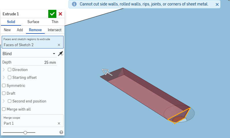

  • SebastianMaklarySebastianMaklary Member Posts: 24 PRO
    @jelte_steur_info Great, that custom feature is just what I needed but it doesn't work on sheet metal models, which is where I need it. Do you know of any way that this can be adjusted to work with sheet metal?
    I’ll look into it
    @SebastianMaklary :
    I'm afraid there's no good way to make it work on sheet metal.
    I tried the most crude way manually , but it doesn't result in a proper shaped slot. (it does end up making a cut, but straight.
    I'm afraid the hole feature is the only non-perpendicular cut that onshape allows in sheet metal… for now…
    @Derek_Van_Allen_BD: I believe you've tested the edges of sheet metal functionality with featurescript. do you see any option to create a slotted slot-hole with e.g. countersink geometry?

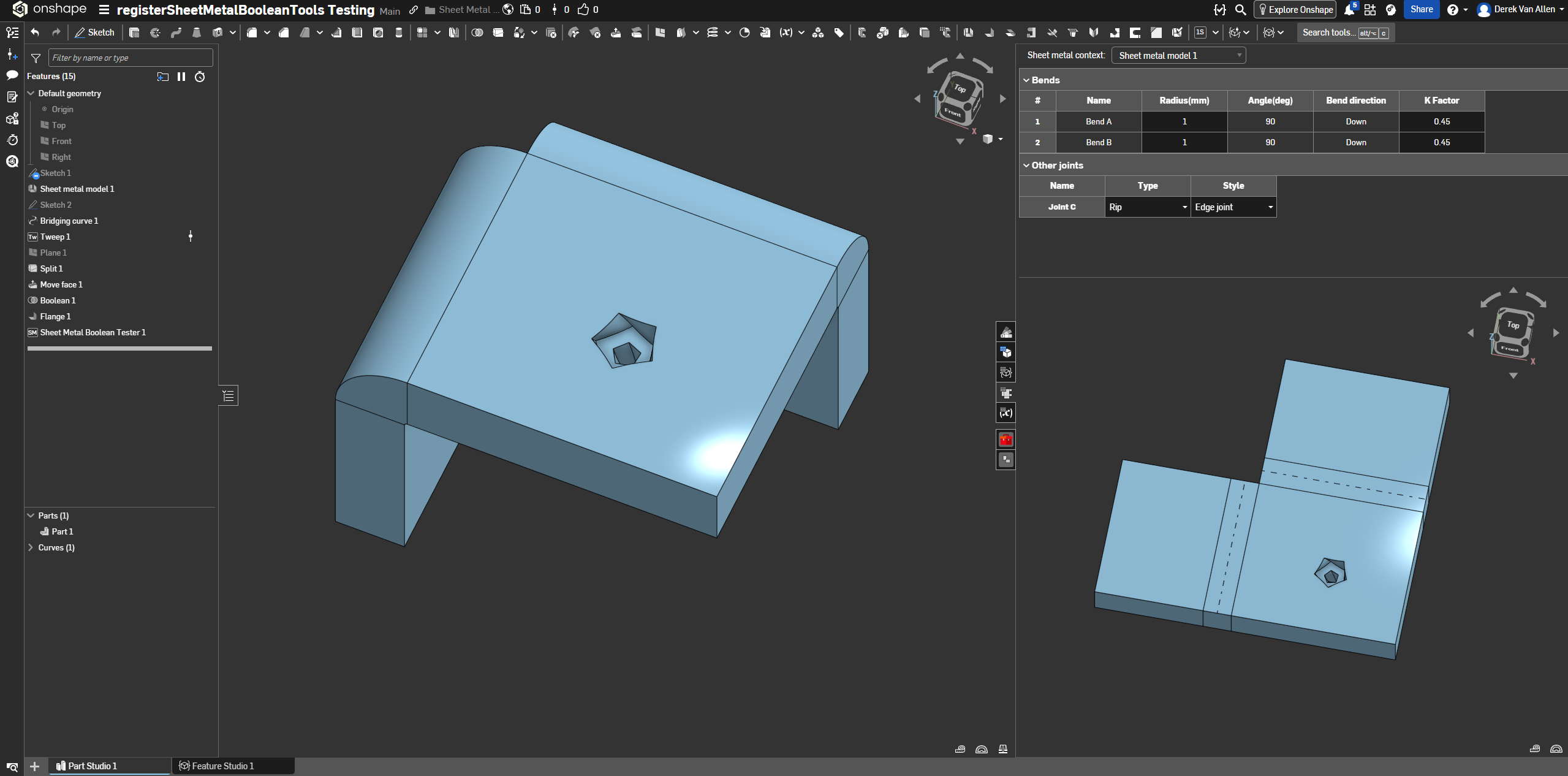

  • Derek_Van_Allen_BDDerek_Van_Allen_BD Member Posts: 758 PRO
    @jelte_steur_info @SebastianMaklary From a manufacturing perspective I do have some objections about countersinking a slot in sheet metal, but bullying the Onshape sheet metal kernel in general is something I can get behind no matter the application. There are a few more ways to get non-perpendicular geometry to build in a sheet metal environment but they all come with caveats. Well 2 main ones. Firstly how much do you care about your tool being limited to only planar surfaces? Secondly how much do you care about the flat pattern environment showing the same features as the 3d view? The form feature allows you to willfully violate most of the sheet metal kernel's checking because it assumes you've got a forming die that does whatever you've desired to introduce to your model at the locations specified, but it requires a bit of setup in a secondary studio and configuration settings, and does not work on curved surfaces nor add geometry to the flat patterns, only a sketch representation drawn by you.
    I did get excited the update that allowed countersunk geometry in holes last year and was looking into turning off some of the guards and flags set by the registerSheetMetalBooleanTools call that allows it to work to see if I could coax it into working on more cases than pure planar geometry or to use it for additive operations instead of subtractive but I recall running into engine side limitations with my experiments. It's been awhile since I made the attempt though and I do need to look into alternatives for my kerfinator script so I could get back into it.
    @lana Looks like I got support for countertweeped holes working in sheet metal
    Is there any way to get registerSheetMetalBooleanTools to support curved surfaces or union operations? How much of that function is kernel side vs featurescript side? I got a kerf bending script that would be massively more efficient if I could support one or both of those things instead of trying to run the math manually and implement a non-sheet-metal unfolder.
  • lanalana Onshape Employees Posts: 758 image
    @Derek_Van_Allen_BD Unfortunately, curved surfaces support is not available yet and most of the matter is on the core side. In order to support this we'll have to create and manage separate instances of the tool for curved wall and for flat. We have customer requests to support such holes, - so some time in a future.
    @jelte_steur_info and @Derek_Van_Allen_BD Thank you a lot for doing what you do but I think you might have misunderstood what I was looking for. I don't need to add 3D features or countersunk slots to a sheet metal feature but just to have an easy way of creating a slot from a hole to give some manufacturing tolerance in one direction. We often have a bunch of holes which then in a future revision needs to be changed to slots to make assembly easier as the physical assembly is otherwise overconstrained and small errors in the bending allowance means that the holes don't line up.
    I am still only interested in perpendicular cuts that are cut with the lasercutter based off of a DXF exported from the flat pattern view but would just like to be able to easily make a cylindrical hole into a slot like the original featurescript from Jelte does.
    edited January 24
    I've been working on a sheet metal model for the the straight slot 'slot to hole' function and have the sketch rendering properly.
    the whole thing will work completely different than the existing function.
    Now i just have to make the cut happen in featurescript but i'm afraid it's not as easy as opExtrude opBoolean.
    @Derek_Van_Allen_BD : how does one cut from the sheet metal model? or where can i find the proper documentation? AI wasn't very helpful on this topic…
    @jelte_steur_info the sauce is all in the registerSheetMetalBooleanTools() function which is otherwise only used in the standard library Hole feature. It's also marked for internal use only and doesn't come with a lot of documentation or any other examples of usage so most of my understanding is coming from experimentation and pure educated guessery.
    The way it seems to work is it takes whatever tool body you've got passed to it and makes a copy on the flat pattern of the sheet metal part in the same location as the 3d model and does booleans for both the 3d view and the flat view while bypassing all the normal sanity checks that the sheet metal engine runs in the background. The registerSheetMetalBooleanTools() function has guards to prevent you from registering tools that interact with side walls, rolled walls, rips, joints, or corners which I assume is partly to prevent entity association bugs when you modify those elements (an issue I'm far too familiar with) and for rolled surfaces they would actually need to be doing some warping of the tool body that gets spawned into the 2d view to flex and deform it to match what the 3d tool is doing and respect the K factor of your unfolded piece. I would wager that the same exact framework is being used for the sheet metal form tools as well for the sketch placement on the flat patterns, but the front facing functions are slightly different and no additive geometry is being brought to the flat pattern view in that case, only sketches. Both tools have the same restrictions though.
    As for how you use it, the ~100 some lines of code in the Black Market Boolean example is really as simple as it gets. Do the rest of your feature as you normally would and make sure the target is ActiveSheetMetal.YES before invoking the registerSheetMetalBooleanTools and the engine should just take care of things for you.
