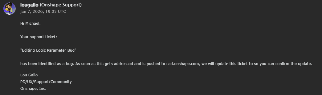

@anil_nakka547 99% of the time these are user errors, however I looked into it, and this actually may be a bug. The product catalog feature is also throwing the same edit logic error even though I haven't touched it since the video. I've created a support ticket. Will see what support says.
If i manually clear the array and then switch enum tabs, there is no error, but if i try to clear the array within edit logic, it goes crazy.
Hey! It was a bug.
I love when I get emails from @lougallo confirming that I'm not insane and that I found a way to break Onshape. I usually just assume I'm the problem until he tells me otherwise.
