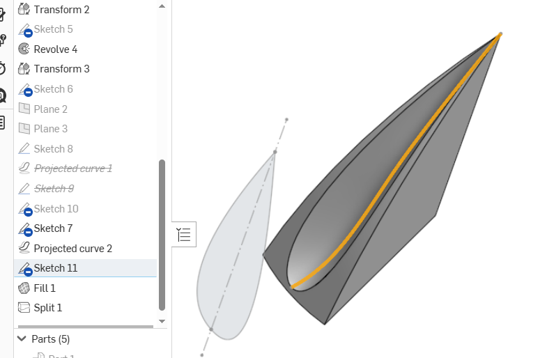

Re: extrude with smooth edges
I did this with split part at a fill fill surface. The surface is done with a fill around the projected curve and a guide.
