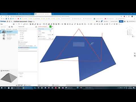

Hello,
I want to move on this part of the two open edges so far that the tips meet on the outside.
These are abraded after laser cutting so that the seam can be welded without adding material.
Is there a way to cancel or ignore the collision to produce the part despite "error"?
https://cad.onshape.com/documents/0164e801f7167a0a3eb81116/w/b3e4f69ec8ffda53a3cef237/e/a55fe9de03020f088752ec94
Greetings Hobie

Add this to your tool bar:
Flatten without redundant edges:
https://cad.onshape.com/documents/d075777b23239493791a6871/v/3a17d545652276fcd92ed873/e/dba9566c2dda32a29752e76b
Then do the following:
https://www.youtube.com/watch?v=Zg1z7TrPawU

Thanks first of all.Could not try it yet.Is there a forum post for this feature?Greetings Hobie0
@lana made it for me a while ago, i think it was an improvment request for something else. But it can do more than it was meant for0
@hobie_smith
If you just have a flat pattern with bend lines that you want to fold, you can use this feature to fold it:
https://cad.onshape.com/documents/9f116620b0f6d04445f57293
