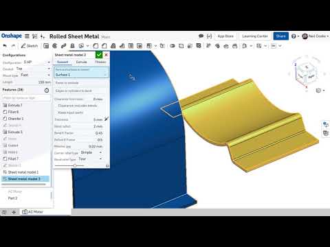

Looking at how to unbend this part here. Its currently in its bent position where it will lock into another part. How can I use the sheet metal feature to unbend this until flat and then create a drawing. The part will be made from titanium.
Kind Regards,
Sean
Kind Regards,
Sean
Twitter: @onshapetricks & @babart1977
Click on the 'bend table and flat view' icon on the right of your screen to see the 'flat view'.
This view can be called up in the drawing. When inserting to drawing the default from create drawing of part does not show flat view but if you pick the icon for insert part and activate the 'flat patterns' icon it will be there presuming your part was generated as sheet metal and not just an extrusion.
