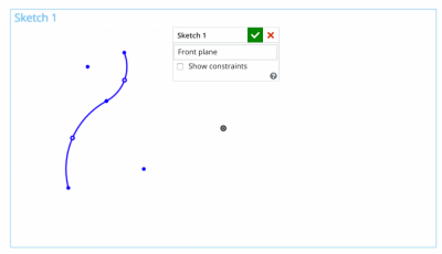

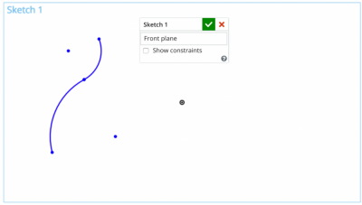

    Below are 2 arcs confined by a tangent constraint:
    I've added 2 points highlighting the 2 inflection points contained in my double arc geometry. Knowing a little math from grade school, I remember the order of the equation minus 1 equals the number of inflection points. Or, because there are only 2 inflection points, I can fit a 2 noded spline on my double arcs:

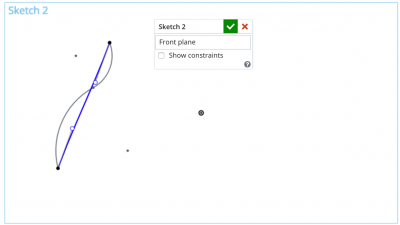

    I've created a new sketch and tied the spline's end points to my arc combo.

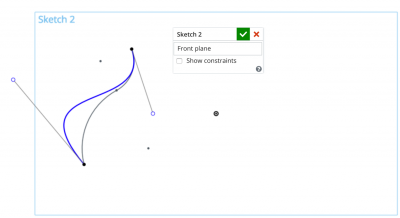

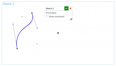

    I can drag the handles around until my spline matches the double arcs (the arcs are underneath my spline):

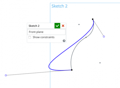

    But, I can have more control and create many new shapes:
    You can do a lot with just a 2 noded spline:

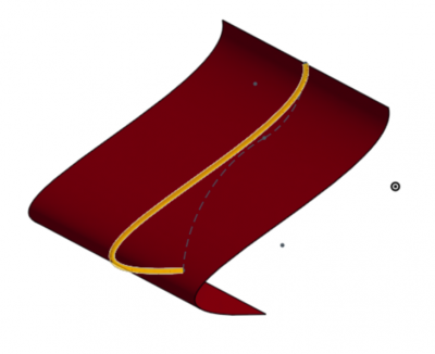

    Oh yeah, extrude a surface, absolutely:

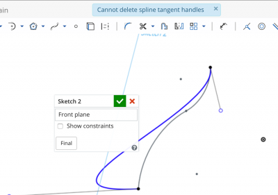

    One thing to note, and I'm not sure in my mind if this is a bug or not, spline nodes can have a natural state meaning no control has been entered by pulling a spline handle. We use to describe the natural state of a curve as the least distance to get to a node. Not sure if it's true but it looks like it is. In OS you can't appear to remove a node's control and return the curve to it's natural condition. I'm not sure this is a bug and want to wait to see where they take spline control.
