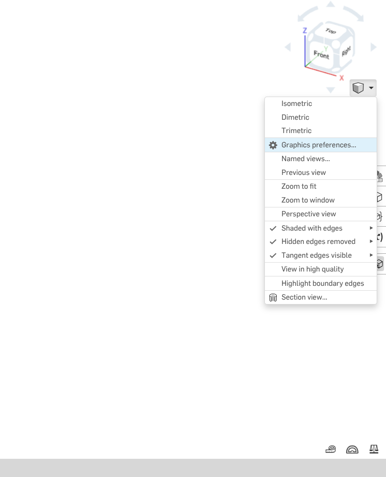

    Its under the view cube, on its drop down. "turn perspective on"
    Great BUT... What is the keyboard shortcut TOGGLE for perspective view ON/OFF

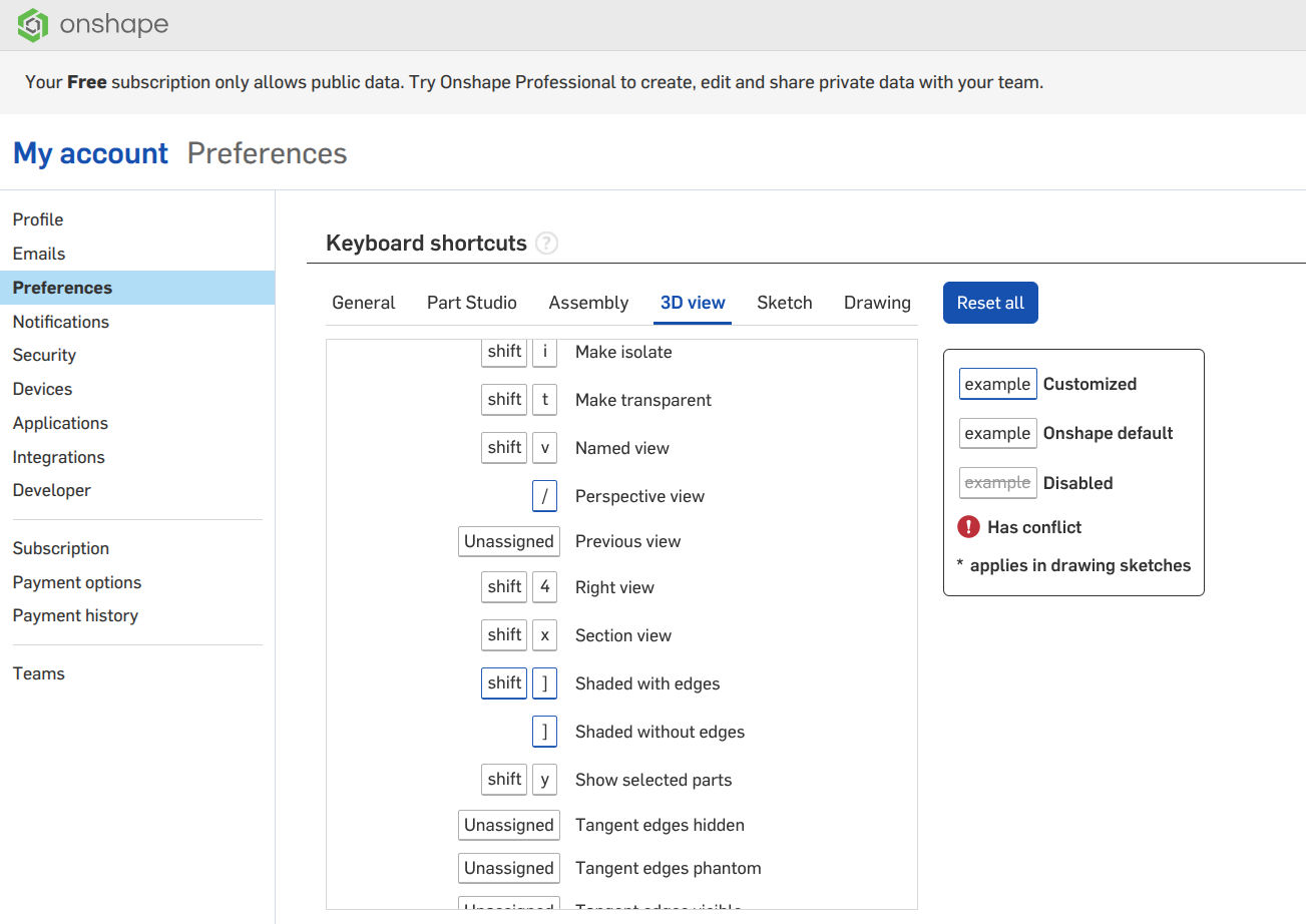

    You can now assign a keyboard shortcut to toggle perspective . . .
    Also, you can now adjust the 'depth' of the perspective view via the 'field of view' setting in Graphics Preferences . . .
