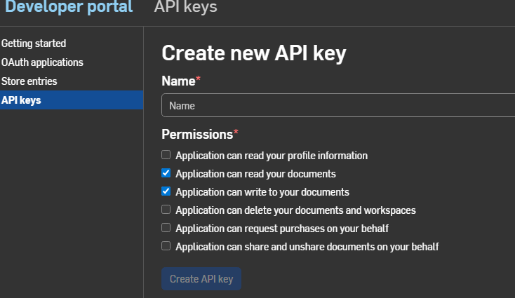

  • vanowmvanowm Member Posts: 116 ✭✭
    I'm getting the same error in API explorer with simple
    {"formatName": "STL"}
    curl -X 'POST' \  'https://cad.onshape.com/api/v12/partstudios/d/<docID>/w/<workspaceId/e/<elementId>/translations' \  -H 'accept: application/json;charset=UTF-8; qs=0.09' \  -H 'Authorization: Basic <base64string>' \  -H 'Content-Type: application/json;charset=UTF-8; qs=0.09' \  -H 'X-XSRF-TOKEN: <base64string>' \  -d '{  "formatName": "STL"}'
    It seems this API required both read and write to documents permission?
    Why in the world does it require write permission???
  • Caden_ArmstrongCaden_Armstrong Member Posts: 352 PRO
    It requires write permission because some options for translation include storing the result in a new tab.
