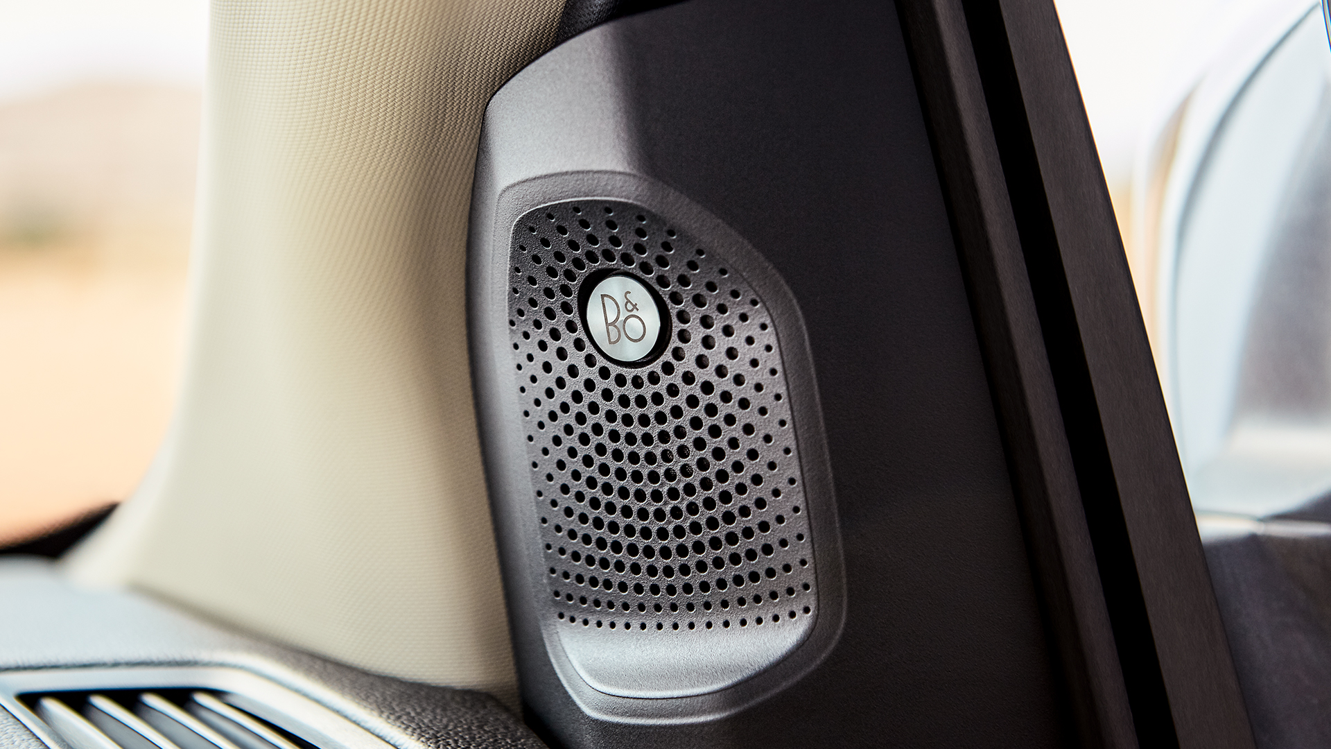

    As it happens, I'm working on a something which needs a pattern of holes for a speaker, and I remembered this feature. It's working well, but it would be really nice to do something like Fill Pattern where you could choose a boundary and optionally a margin. It's not hard to tweak the dimensions to get there, but I suspect that since this was one of your oldest efforts, you might be able to tune this up a lot more easily now.
    I'd also love to see some more pattern options. I'm not sure where you'd stop, since there are zillions of them out there, but a few more would be nice.

    Again, I'm not sure where you'd stop - it's an infinite space, but here are some basic selection of ideas which I could see being incorporated:
    https://www.speaker-grill.com
    https://www.shutterstock.com/search/similar/428647408
    You can quickly go off the deep end with patterns on Pinterest, etc:
    https://www.pinterest.com/pin/439171401140112138/

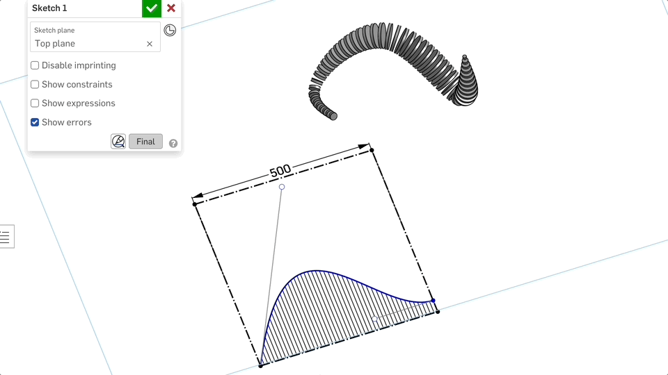

    I started but didn't yet finish a tool to use a sketch as a graph mapper. Definitely doable. This one remaps the numbers too so the min/max sizes stay the same and the graph controls how it transitions between them.

    Hey that's exactly what I was hoping that would look like when I was gonna get into it. Do you have support for piecewise paths for more complex forms?
  • EvanReeseEvanReese Member, Mentor Posts: 2,821 PRO
    nice! what do you mean "piecewise paths for more complex forms"? like chains of curves?
  • Derek_Van_Allen_BDDerek_Van_Allen_BD Member Posts: 709 PRO
    Yeah like say I want to start out and end with linear behavior but smooth between the two with some cubic Bezier curve or spline. Or if I wanted to draw the top half of the batman logo and use it to drive some geometry.
    Yeah that's totally possible but I didn't get there. Yet. This was more of a proof of concept. In the end it just spits out an array of values as a variable so I can get at them in any kind of pattern feature later with an iterator variable #i.
