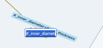

    I am also bothered by the sketch dimension input field being too small. Not even a full variable fits in. (since scope of variables is global, their names are bound to be longer).

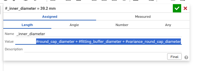

    A workaround I figured out is to make a new variable for that input field (overhead that i don't like). The variable editing window can be resized with the mouse (clicking and dragging it's right edge). This provides sufficient space for formulas. And is probably also a solution your struggle @sergei_nesterov.
    The drawback is that more variables get created in the features list and clutter the workspace a bit. Having the option to have variables being local to a sketch would help here.

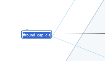

    I also struggle with the fields far too small. I want to do a difference between two variables. And not even one variable fits into the display field.
    How could I edit the equation better? - meaning see more of it while editing.
    (when hovering with the mouse the whole field gets displayed - i can't screen shot it - which is nice to inspect. It would be awesome to also have a bigger field for editing)

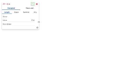

    @klaus_krämer Please excuse the poor quality. But you've been able to click and drag to make the dialog boxes in Onshape wider for a while.
  • eric_pestyeric_pesty Member, pcbaevp Posts: 2,640 PRO
    But not the input boxes in sketches so if you want to use expressions in the dimension input it's still a pain…
    Creating an extra variable just to be able to "comfortably" edit it is still just a "workaround"…
