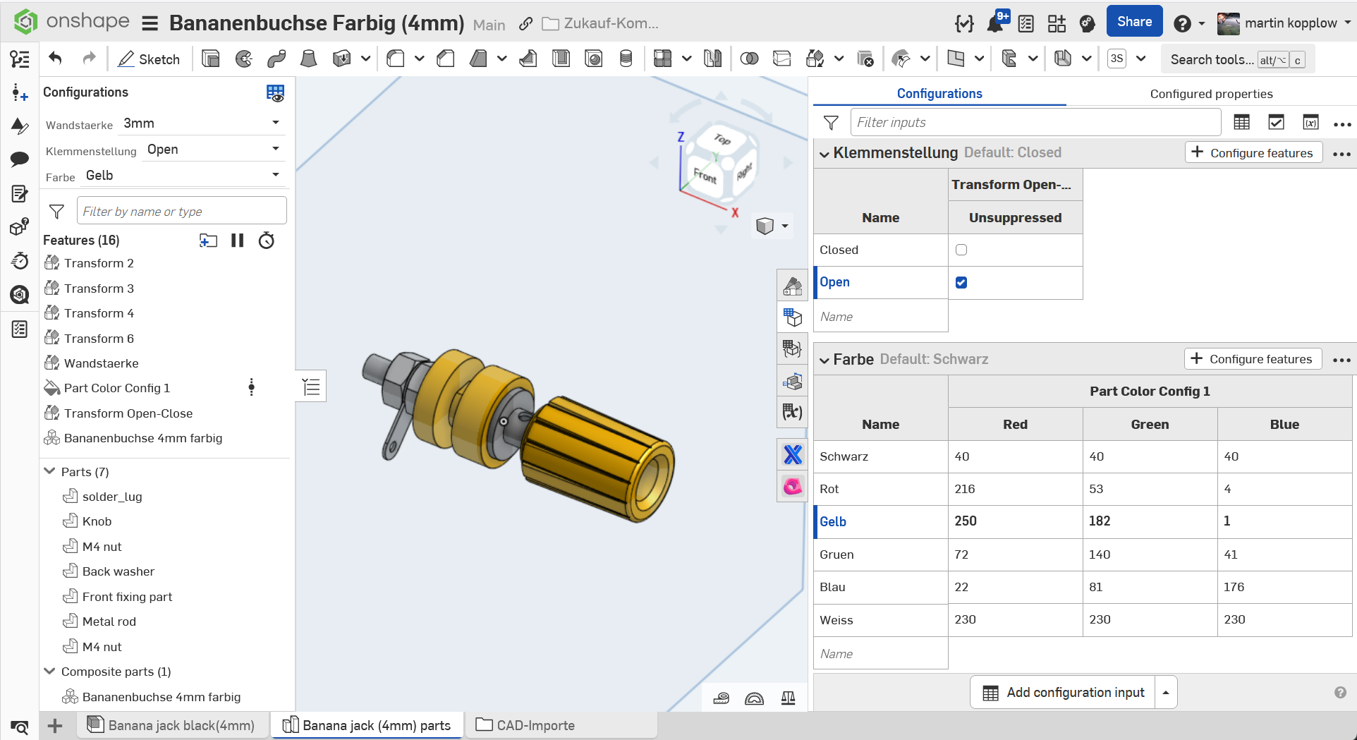

I made a Part Color feature here. It's useful to change the appearance of a part with configurations. I know you can configure the appearance of parts in the Configured Properties, but you're limited to setting up each possible permutation of the design, which is onerous especially when using a variable configuration that could be changed to anything. I needed something like this for something I was working on, then my wheels got turning on whether I'd be able to figure out how to drive it with a hexadecimal code, and it turned into a project-based learning exercise for me. I hope it's useful to someone else too.

  • AlexPittAlexPitt Member Posts: 22 ✭✭
    A nice development @Evan_Reese! Great little icon too! I copied, liked it and had a play, setting up a config table as with Neil's.  As you say, just need to remember to not use the OS native colour picker which overrides the FS (as per any feature script affecting properties).  The ability to use hex code is great for quickly pasting colour refs in from the web.
