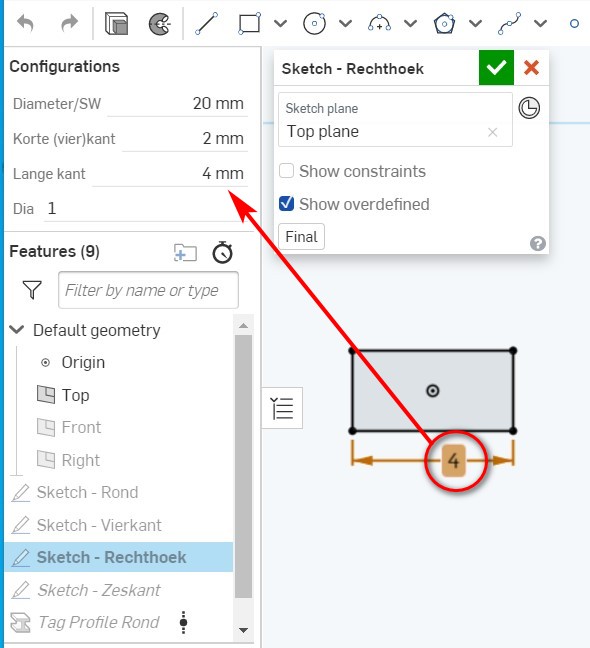

    @NeilCooke,
    I have some simple custom beam profiles that are configuration driven.
    I like to use the sketch/config dimensions in the Cutlist column Profile. (The height of the sketch above is equal to the config value ‘Korte (vier)kant’ from ‘Sketch - Vierkant’.)
    In this case: the config variables ‘Korte (vier)kant’ en ‘Lange kant’ as (in this case) ‘2 x 4’.
    I do not succeed to  select the config variables to use them in the Profile field.
    As a test I made the text config variable ‘D’ and tried to use that instead of the mm variables. Also without success.
    How can I use config values instead of filling in Profile by hand?
    Or also less specific: can you explain more in detail how to make use of configs in a Cutlist?
  • NeilCooke
    Hi @Henk_de_Vlaam - using config variables would not work since the profile sizes are text and there is no way to convert values to text (you can, but they are always converted to meters). So this is how I am expecting it to work:
  • Henk_de_Vlaam
    Henk_de_Vlaam Member, Developers Posts: 269 ✭✭✭
    edited June 2020
    Hi @NeilCooke,
    A while after submitting my question and suspecting that Profile could not be filled per config variable, I thought that a configuration list could provide the solution, just like your suggestion.
    Thank you.
