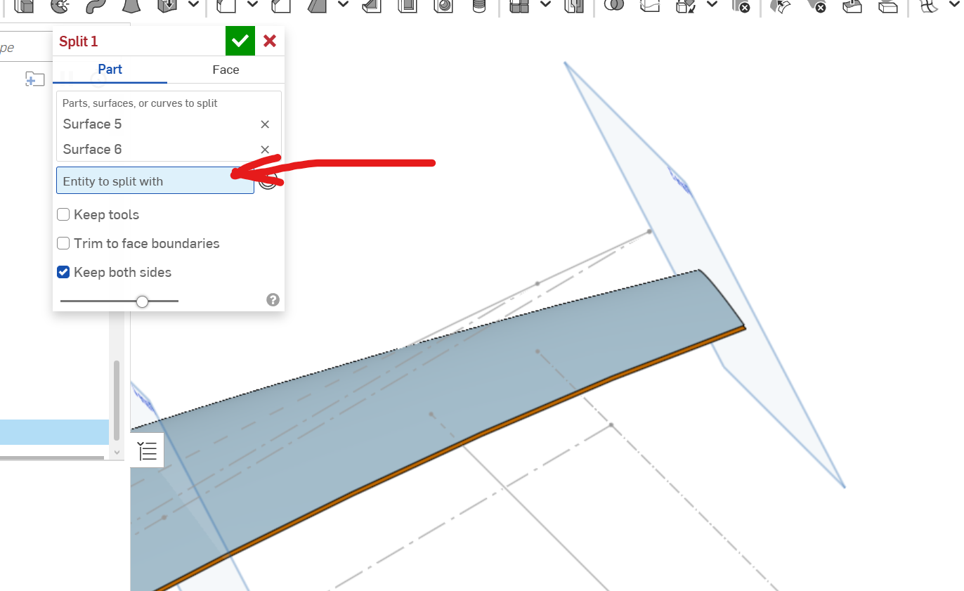

  • t_e_s_t
    t_e_s_t Member Posts: 9 ✭
    It would be nice if they would put ability to pick the trimming or splitting sketch here. But for some reason it does not allow it.
