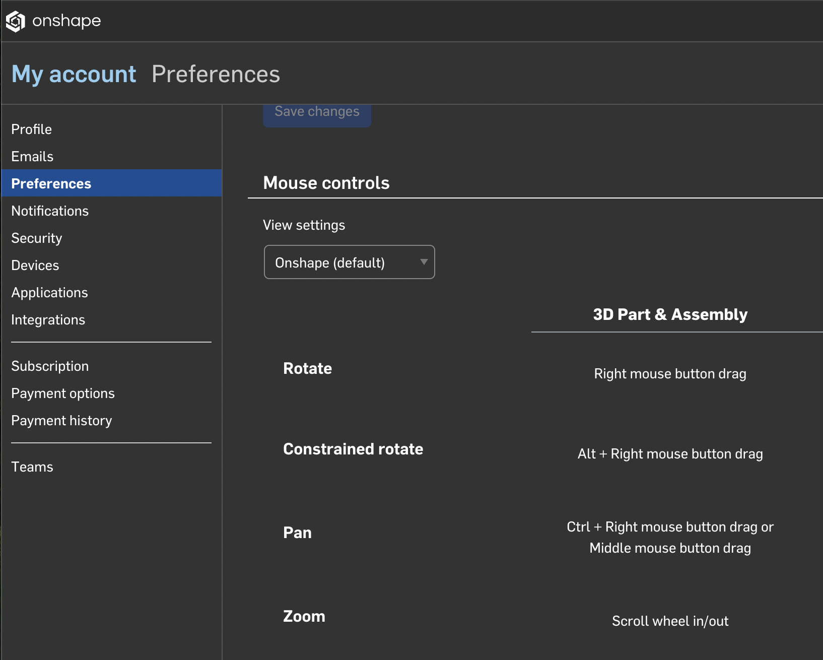

    I found the issue finally! I had my mouse control preferences set to Creo, which uses the middle mouse button for both pan and rotate. There is no middle mouse button equivalent in the mac trackpad. When I switched my preferences to onshape default, the trackpad worked. I think I will open a feature request to allow separate settings for a physical mouse and a trackpad.
  • roger
    roger Member Posts: 8 ✭
    Both Creo and SolidWorks use the middle mouse button drag to rotate. Thus, if Onshape's mouse settings are set to either Creo or SolidWorks, you will be unable to rotate the model when on a trackpad. nick_papageorge073, did you ever open a feature request to allow separate settings for mouse and trackpad?

    I thought I did, but in my 6 pages of feedback/questions to support I did not find it. They are probably sick of me:) Incidentally, my fix was just to put Onshape in default mouse mode. I ended up getting used to it in a matter of minutes on my 3 button mouse, and it works for the trackpad too. This, after using Creo since the 1990's.
